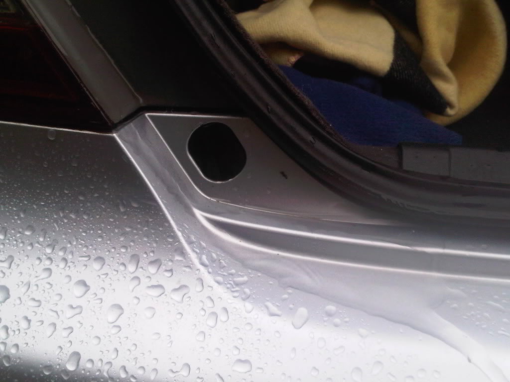

1: Locate the two black plastic caps under the bottom lip of the trunk, and carefully pry the caps off. Under each cap you will find a 10mm bolt, remove them.

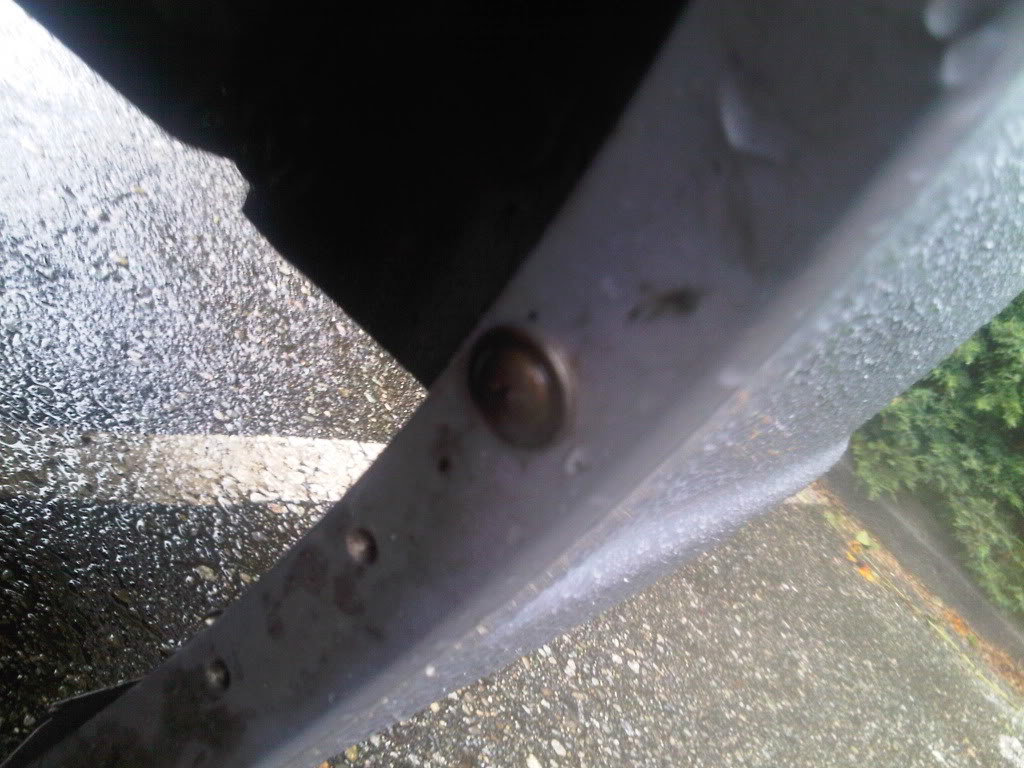

2: On the underside of the bumper cover you will see two black clips, with a flat head screw driver carefully pry the center tabs out and the clips should slide out.

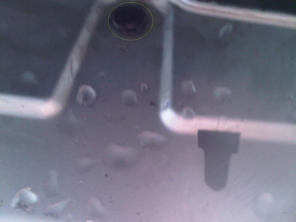

3: There is one screw on the inside of each wheel well, remove them with a phillips head screwdriver.
