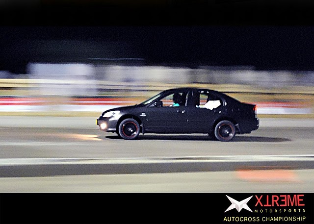

^lol u took ur stock-height vtack civic to the dragstrip?
just curious? whY? to find out it takes 20sec to get to 60? i mean its so slow u can pretty safely do that on the streets...lol

I think it's autoX, and if you have a lowered car you fit into the modified group which is much harder than the stock. Hence why it's stock height. (All assumptions)

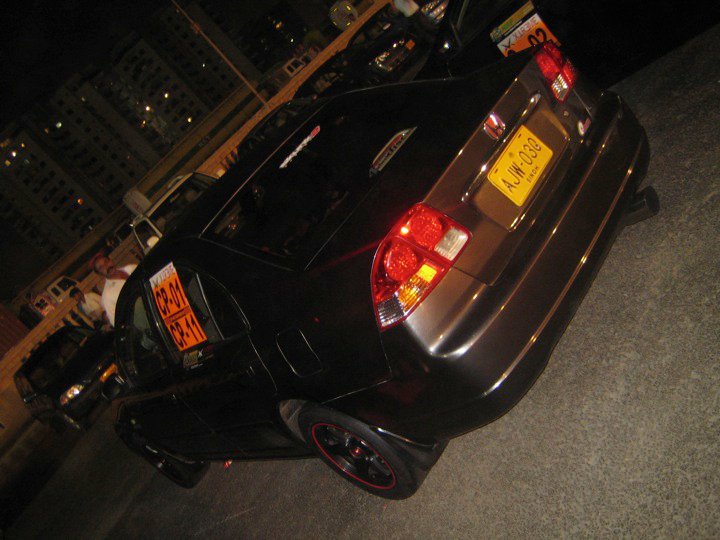

I just clicked the pictures and gah damn that thing is riding high..

14" rims with small tires?
Old Jun 20, 2010
Rep Power: 513
Re: Honda D17
still riding high.. compare the fenderwell space on top of the tire (12:00 position) compared to the sides (3 and 9:00 position)

Yeah... really, why is the car running so damn high? It looks like he's going offroading or something.
Even stock height is not that high.

hey its high for sure its on stock height ..... and this is car used by me on an autocross circuit in pakistan ..www.xtrememotorsports.com.pk and it had the fastest time of the day in the last event ..... about your opinion on lowering actually i lowerd my car in the 1st Round and it didnt handle that well soo .... i changed my tyres and put on Kumho Ecsta V710 Racing Slicks and got my height back to OEM and I liked the way it handled.......If u are an autocrosser then ur advice can actually help in a bit but if ure a dragster or a street racer then i have one thing to say " Lowering helps you more in a circuit racing but it dosent help u that much on an autocross circuit it depends on what speed u reach on a autocross track....."
Try visiting the website and see what kinda cars are thier in pakistan check out the racing scene cant compare it to the US and other countries ......

I HAD IT LOWERED THOUGH !! BUT I LIKE IT STOCK HEIGHT ......
Actually I have bushings installed aswell as Sway bars it doenst have any roll I forgot to mention that earlier ....pic is attached
