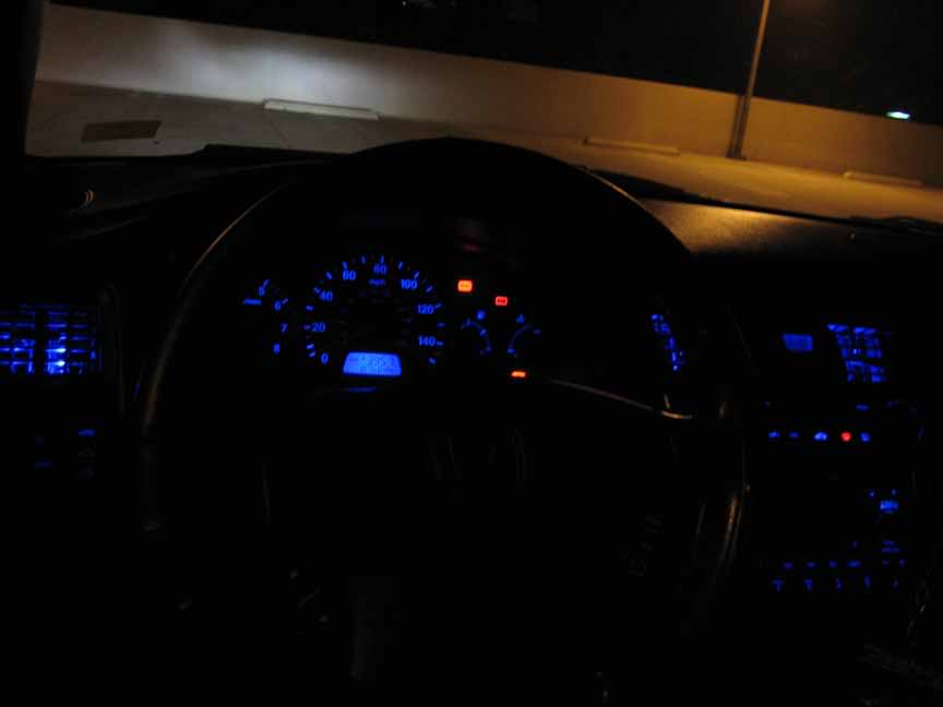

Here is a pic of my old ride...
and

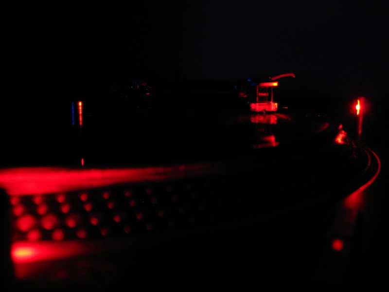

Oh and here is a pic of my technic led mod...

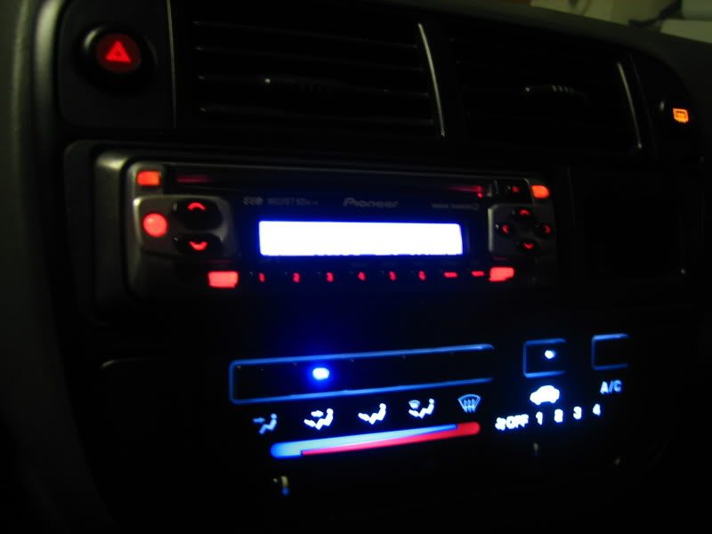

heres mine. nothing fancy i just like cool white and the fact i never have to relace them or worry about them burniout.
EDIT: the more bluish ones were some cheap 5mm leds i got from china and the bright white ones are quality NTE 3mm.
Your coding is right, but no pics. Weird.
Old Sep 23, 2009
Re: 98 LX center console and gauge LED swap
i see the pics

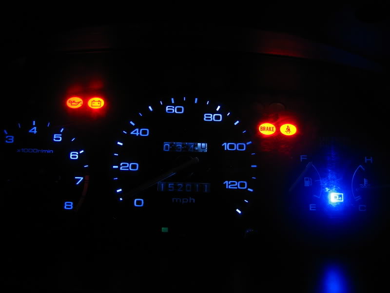

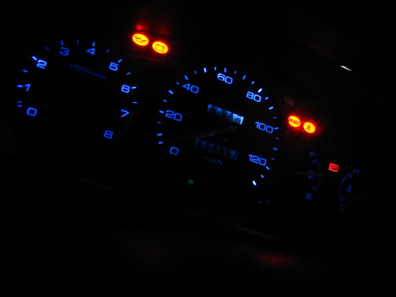

Here are the pics...
They still need some work, the gauges that is. Behind the fuel/temp gauge I sanded down the leds to see how well it would disperse the light. I was not happy to see the output though. I proceeded to take care of the rest of the leds and I forgot to redo this one. The P, R, N, D...lights have been replaced for blue leds but I need to re-aim some of them and I also need to redo those with a higher resistor because they are too bright. Here is a pic so you can see what I mean...
Overall though I'm pretty happy with how it came out. I'm going to be fixing those few bugs probably this weekend and I may add some leds in other parts of the car too. What are all your thoughts on my work? Any suggestions?
