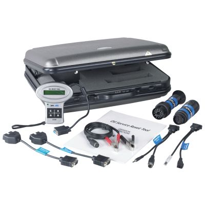

generic obd2 scanners cannot access manufacturer specific functions. There are scanners out there that can do it, but are gonna be priced similarly to the HDS, but are flexible enough to use on other makes. There was a company that used to make devices that you could connect to the DLC and whose only function was to reset the oil light, I dont know if they still make them or if they make them for honda. damn that "type B" service light.
thats a $290 matco oil light reset tool for use on VW/audi, benz, bmw and volvo. Like i said, you might be able to find a jap version somewhere else.
