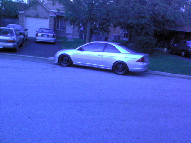

this last one is pre-drop...for everyone debating getting lowered, DO IT!

Wow thats alot of pointless work for steelies, you coulda bought some rustoleum gloss paint and spray ur wheels, I didnt even mask mine off I sprayed the tires too. Looked like permanent tireshine for a month. Lemme look for a picture

^^dooo it DO IT

^ I think hes already done it?
yeah, but if you've got to sport the steelies, sport them right haha.
Now THATS what i call bad practice and the kind of thing that makes honda owners look like ricers...my friend did that to his steelies with green paint and got it all over the tires it looks retarded

black is black
what the hell are u talking about... its basically the same **** you did??
painting steelies that are supposed to have hubcaps on them with spray paint is what gives the ricer appeal.. thats alot of work for nothing... i see no point in this or why someone would want to do this....
black is black..thats right.

that is pretty much contradicting your original post of painting steelies
id rather ride hubcaps! lol

yea i had no hubcaps when i first got my car, i put my hubcaps back on now. live n learn
painting steelies isnt rice....spraying paint over the wheels and tires too...thats rice IMO but have it your way.
