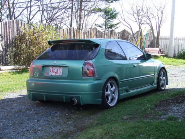

Hi everyone, I'm new to this forum and new to this whole civic/import world. I dont know a whole lot as of yet, so I'm trying to learn as much as possible.
OK, I have a 1996 Civic Hatchback, it looks the part (body kit, wheels/tires etc etc) BUT, only has a stock 1.6L engine!...I've narrowed it down to 2 engines, but cant decide what one to go with. I'm hopping someone on here can help me in my decision.
it's either gonna be a 1.6L DOHC VTECH (there are a few different ones out there, i dont know the difference between them) OR the H23A 2.2L with 220hp, I'm told thats the engine out of a prelude i think.
I've been told that i should go with the 1.6 because its easier to get parts for, I dont know how true this is...I just want as much power to the wheels as possible
Thanks in advance for any replies

nice job on picking the hatch up but get rid of the kit and altezza tails and get yourself some oem bumpers and etc...anyways you have many engine choices but h23a or the h22's from the preludes are hard swaps...you're better off with a b16a from a 99-00 civic si or b18c1 from a gsr...easier drop in swap...i have a 2000 hatchback that im workin on and im gonna keep it 1.6l sohc for the meanwhile with a turbo kit...oh and btw its vtec not vtech

Keep in mind turbo takes some work and its not just one of thoes things you slap on and take it for a spin to test the gains. But as far as the tails, I they arent horrible, I rather see you tint them before you loose them- they might look pretty good.
As for the kit, I guess its a little much, but I've seen so many people put so much wrong crap on that hatch that it just doesnt bother me much anymore and to be honest, I think its kind of acceptable, on that car. The rear spoiler does look a little large though. But its a nice car to start with, I've been wanting to pick up one of thoes cars to mod on the side.

Nice kit.. gotta let the taillights go... btw are those TSW's ? If they are... man havent seen those in a while
What's a TSW??

Originally Posted by greenmasheen
What's a TSW??
wheels
