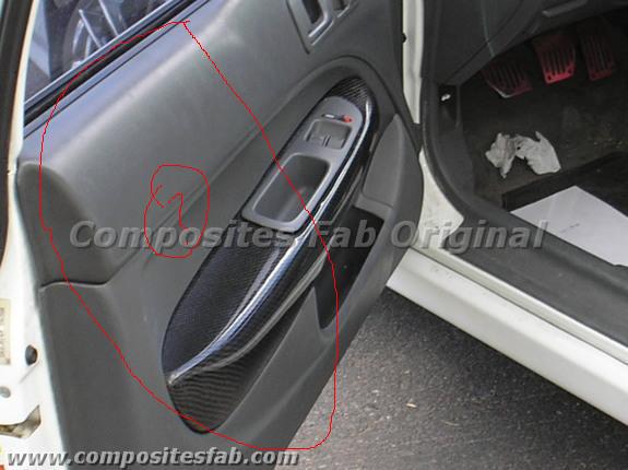

got a question :
when i want to remove the front door trim panel to change my speaker, is the one that i marked big circle supposed to be all out ? is it one piece ?
thx...

Originally Posted by aonyoung
got a question :
thx...
Yeah the whole door is one piece, make sure you push it up after pulling all the plastic clips.
