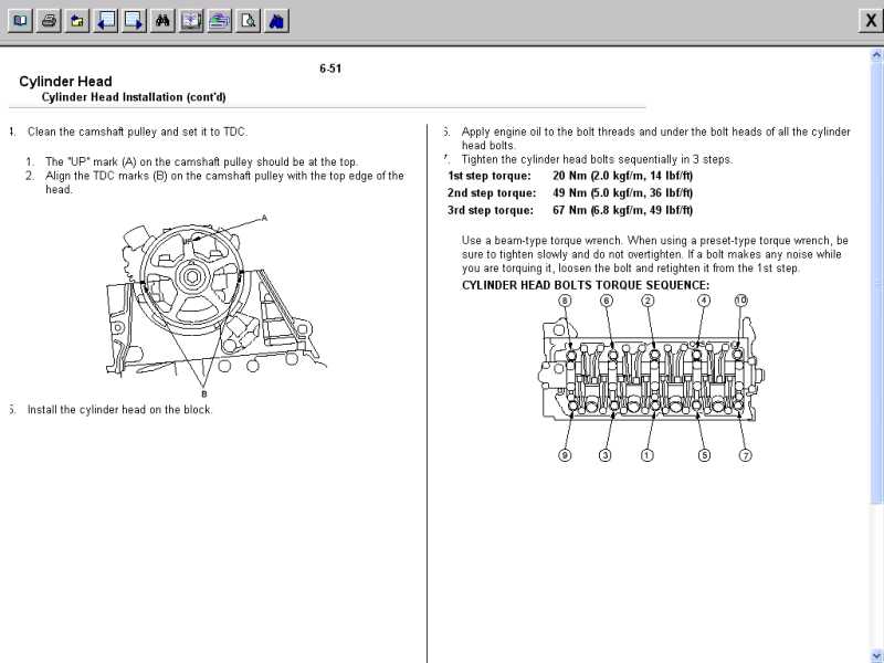

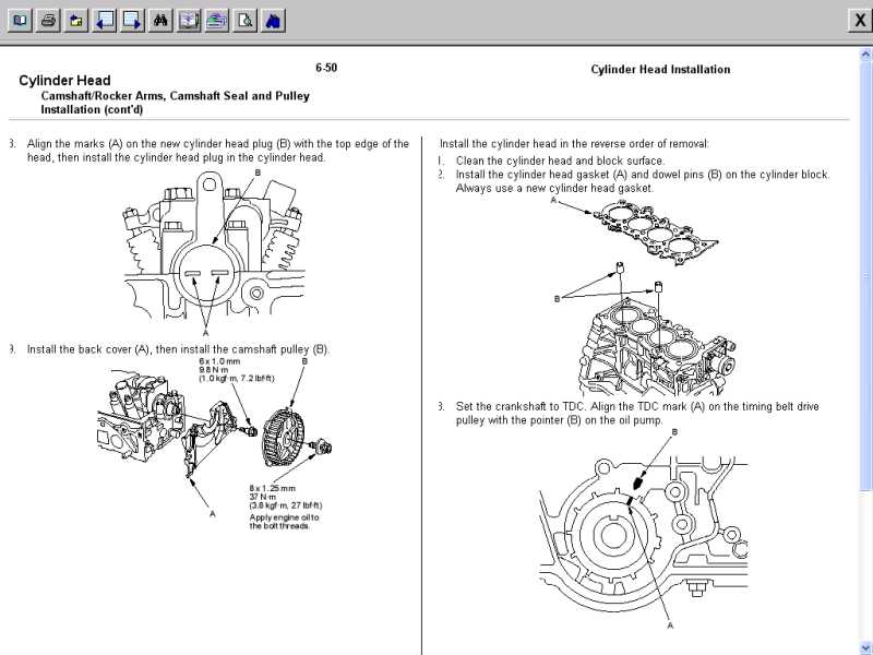

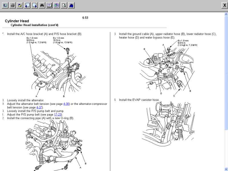

i need the pages that show the torque specs for all the parts of the cylinder head. specifically; the head studs, valve springs, rocker arms, and allt he other bolts in the head the connect it to the block. i would appreciate if you could attach or host the pictures so i could get a better visual. thanks

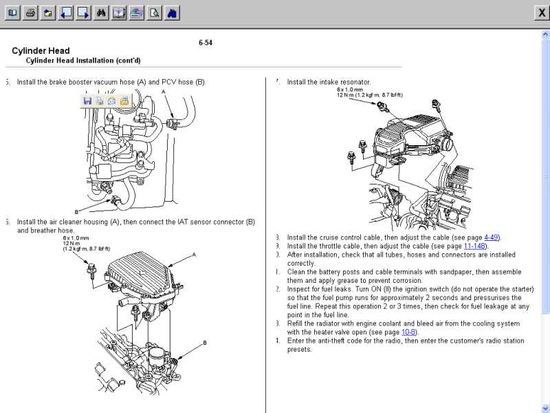

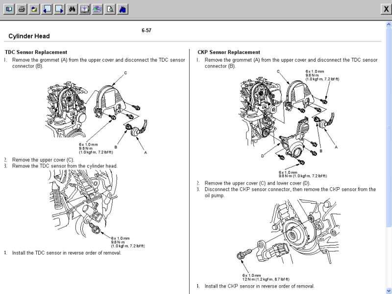

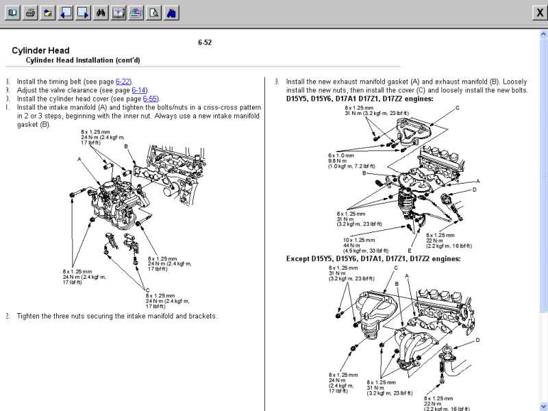

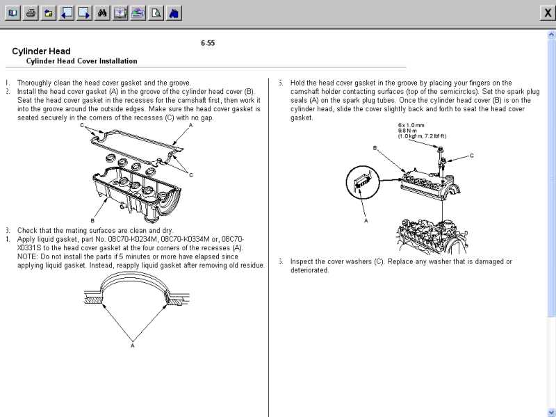

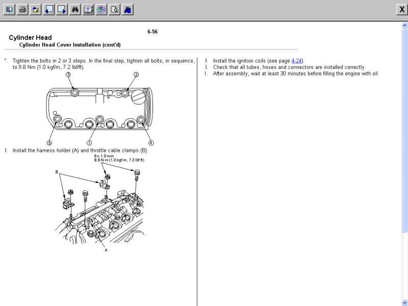

Well....here goes
HERE is a pdf format of it!!!!
ID:	62348   Click image for larger version
ID:	62349   Click image for larger version
