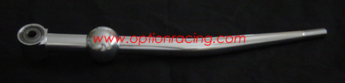

Old Oct 9, 2004
2slow2run's Avatar
wut time is it now
Posts: 285
From: 714
2slow2run is an unknown quantity at this point
this is wut my short shifter look like
Old Oct 9, 2004
jgoodfella1's Avatar
Posts: 465
From: Southern California
jgoodfella1 is an unknown quantity at this point
That looks like a shifter from the 6th gen.
Old Oct 10, 2004
xproductionz's Avatar
Posts: 3,120
Rep Power: 298
xproductionz is just really nicexproductionz is just really nicexproductionz is just really nicexproductionz is just really nice
yea.. thats not for our cars... not unless they know something i dont
Old Oct 10, 2004
2slow2run's Avatar
wut time is it now
Posts: 285
From: 714
wat? how does ours look like?
Old Oct 10, 2004
jdm_bb's Avatar
Posts: 1,570
jdm_bb is an unknown quantity at this point
i don't think that's for our car.... looks like for a 6 gen.
Old Oct 10, 2004
2slow2run's Avatar
wut time is it now
Posts: 285
From: 714
ne1 have a pic of how ours look like?
Old Oct 10, 2004
2slow2run's Avatar
wut time is it now
Posts: 285
From: 714
but u do noe wut im talkn bout thou?
Old Oct 10, 2004
CapYoda's Avatar
Escaped Convict
iTrader: (30)
Posts: 6,450
Rep Power: 369
thats for the 6th gen.
we have cable linkage shifter.. its a lot different. (hence no vibration from the stick)
take a look at the Revo SS.. or the short shifter adapters.. thats why most are short shifter adapters..
do a lil search on it. should be obvious when u took off the console that the shifter u bought isnt meant for our car.
Old Oct 10, 2004
2slow2run's Avatar
wut time is it now
Posts: 285
From: 714
so when we buy the ss for ours it already have a welded metal on to it?
all we gotta do it take it out n snap on the cable n rdy to shift?
Old Oct 10, 2004
CapYoda's Avatar
Escaped Convict
iTrader: (30)
Posts: 6,450
Rep Power: 369
yup the revo ss is a complete swap.
the B&M SS will require the use of the stock housing, u'll have to take it apart and put in the shift stick.
the adapters, you just put the adapter on the stock shifter bracket, and they change the shifting point.
there's picture of the revo SS, or adapters on my site: http://home.socal.rr.com/capyoda
if you check in the tech section.. there's picture of short shifter installed, I think there's a few DIY.. so you can get a better idea of how these things work.
