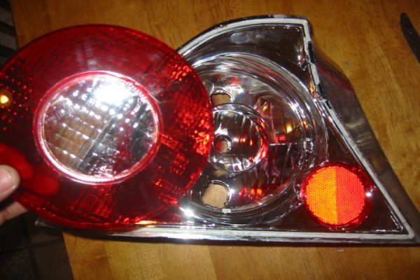

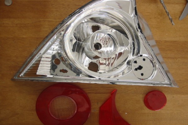

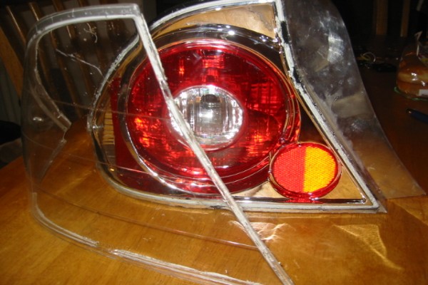

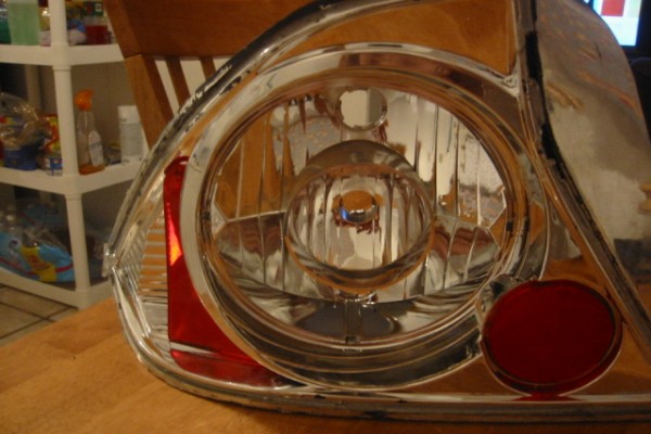

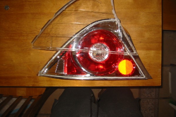

ok i got it i forgot i had one extra one so i did it on that one before i did my one on the car here are some pictures. The real ones on my car im going to do them white.

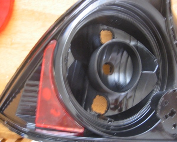

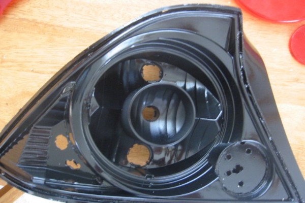

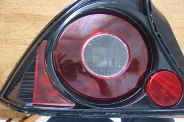

Ok i did the practice in black here are the finished pictures.

  #38
Rep Power: 812
Wow, you actually made those tezzas look good. That's some nice work.

so....did you do the oven thing to get them open?
Old Sep 23, 2004
  #40
jkob2k1's Avatar
Posts: 101
jkob2k1 is an unknown quantity at this point
Yeah what i did was put them in the oven for a few minute than take them out cut the silcone away then put them in oven again and do the same thing over an over till i got it open . i had it a oven at 350
