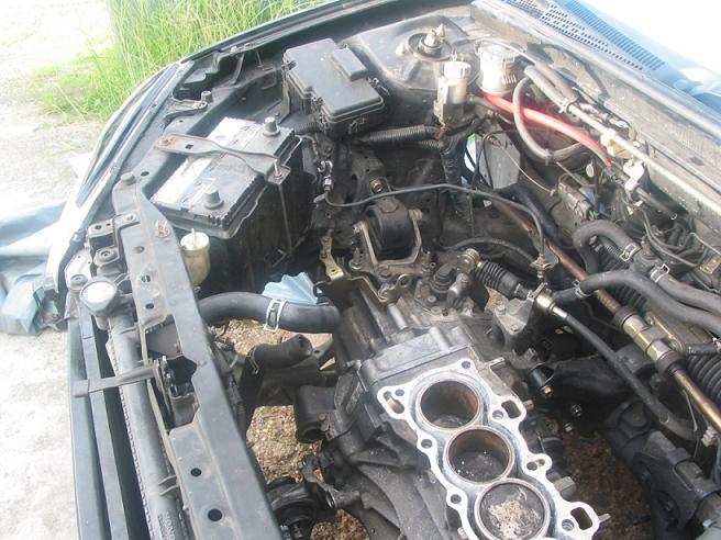

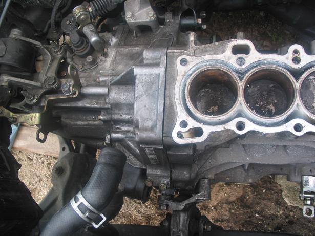

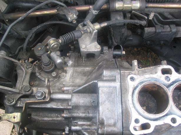

Ladies and gents just FYI our gearbox (03 EX) fit onto the D15B engine like stock. With this knowledge on hand it could be expected that it will also fit the D16Y8 engine as well (I don't have one of the D16Y8 block but I have the D15B and it fitted perfectly) ....

I'll take pics of the D15 Block bolted to my D17 Gearbox in my 2003 EX shell.. (Just for your info crower has my engine doing R&D ) and I agree LSD is the way to go.....

Aight people I don't BS about anything I post, so here yah go........

I don't know why everyone is stuck up on just the gear box issue (being swappable, interchangeable gears etc....) I was more looking at putting a D16Y8 block & head on our gearbox and also use our D17 crankshaft in the D16Y8 block (a cheap stroker kit, it works) and put cams into the D16Y8 head etc (there are alot of performance parts for the D16Y8 block on the market........ That is what I was more looking at!!!
Who would be the ginne pig on this one?????
