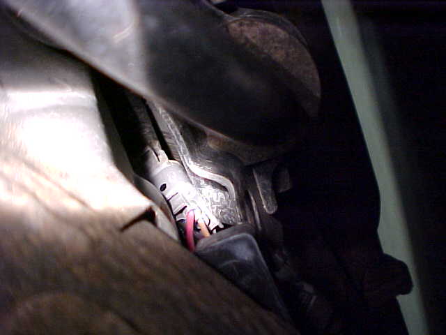

was wondering if anyone had any info or pics to show where to install this sucker...didnt come with any instructions and i searched but it was pretty brief details...anyone???? pics would be great if possible...

i had one on my si.. plug it in on the second O2 sensor.. when u are under your car find the 2nd one and follow the wire.. there should be a coupler and u stick it there... hope that helps

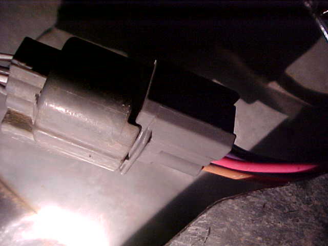

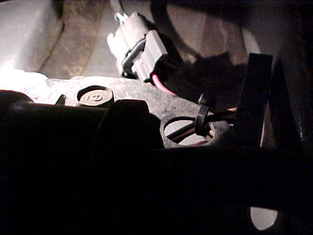

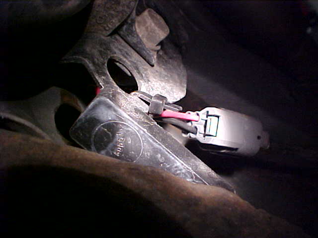

I posted this about a month or so ago, but I can ablige with some pics---it really is easy though nothing to think about. at the cat O2 sensor unplug the O2 from the harness plug (after disconnecting the Battery) and plug the O2 sim into the Or plug and then the other side to the harness plug, its sietup almost is OEM in style so no worries and it stilll is working in mine---

thanks for the pics...it was easy when i actually went to install it took about 30 min, though cuz i had to jack the car up...seems to working good so far...well see.
