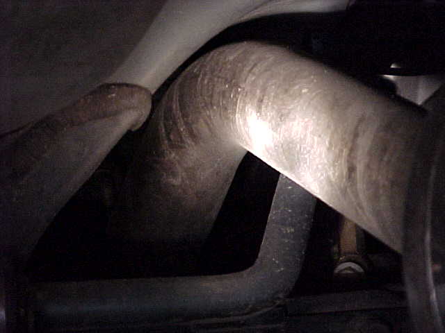

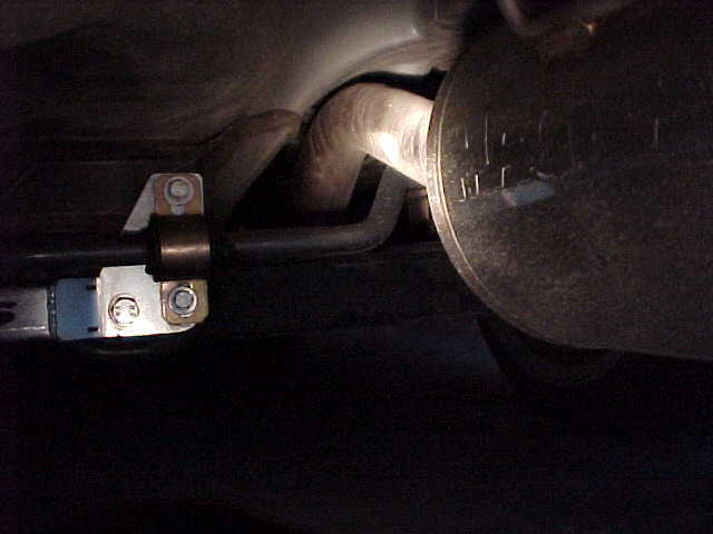

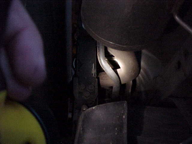

Hi, I recently installed a Magnaflow catback on my 03 LX. Everything went smootly except that the piping that connects the muffler to the resonator hits the frame of the car when I turn. This piping bends to clear the rear control arm. It looks like it's bent too high, that's why it's hitting. Does any1 have a solution to this problem?

Thanks for your help guys. I'll try to adjust the exhaust again. I took some pictures of where the pipe is hitting, but they're pretty low quality. It only hits when I'm driving (turning). There is actually a little space when it just hangs there.

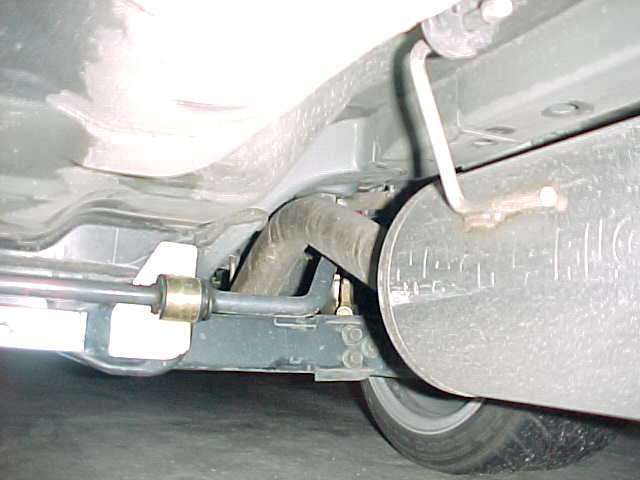

Crackhead79, if you could take a pic of your exhaust pipe that goes over the rear suspenstion and connects to the resonator, I would really appreciate it.

Not a problem give me minute, mine will look different though, because I'm dropped on the hayames and have a progress 22mm in the back-
Old May 17, 2004
Crackhead79's Avatar
Posts: 900
From: Colorado Springs, CO
Funny, I went to download the pics and the server did but then all my ride pics are gone-? WTF? oh, well here the are sitinduk one-by-one.

Crackhead79, your pipe definitely has more room to move than mine does. I noticed that you guys all have EX's. I wonder if the exhaust hangs differently on the LX or perhaps mine just happens to have a defective bend. I've emailed Magnaflow about this, but they haven't gotten back to me yet. I'll probably reinstall the stock exhaust so nothing gets broken in the mean time

Update, I've reinstalled stock exhaust. Magnaflow finally got back to me. I had sent them these pics:
Here's what they had to say:
I showed the pics to my engineer and he said it looks pretty normal - the Hondas have tight clearances. He also said you should have between half an inch and 3/4 inch clearance right there where the tailpipe comes close to the frame. So if you have less than that, just loosen the system, re-align it and tighten back up after making sure you have proper clearances. Other than that, if you are still having problems, I would say just get some new rubber grommets from Honda. Hope this helps, thanks again.
I guess I'll try to reinstall the Magnaflow one more time. Maybe I just have to give it time to break-in.
