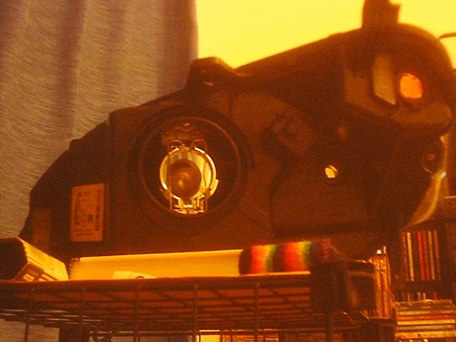

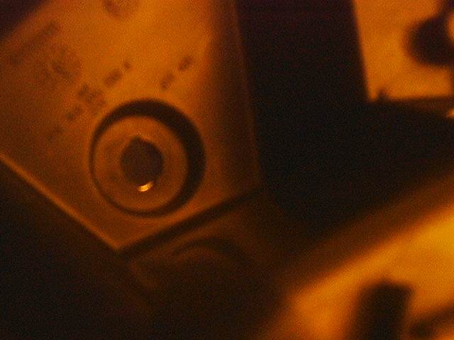

these are pics of the 02 coupe headlight
ok, this socket IS BIGGER than 03's

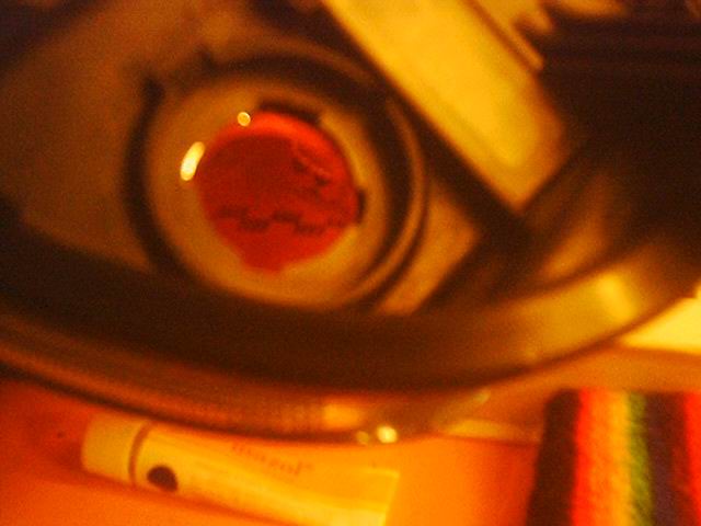

Old Apr 19, 2004
zen_master's Avatar
Posts: 3,784
this one is the same

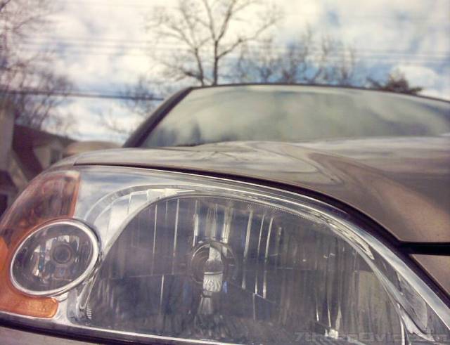

Old Apr 19, 2004
zen_master's Avatar
Posts: 3,784
overall...

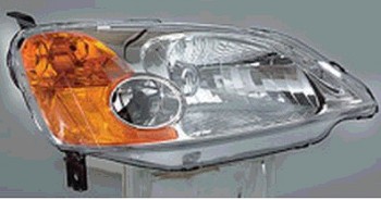

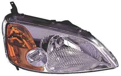

Coupe Headlight

Old Apr 20, 2004
82801BA's Avatar
Posts: 842
From: Austin, TX
82801BA is an unknown quantity at this point
Look at how nice the reflector on the sedan is....

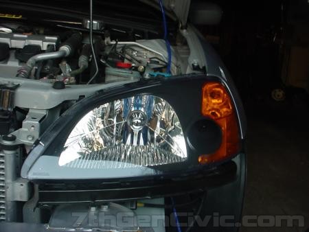

ok, my point is...
you have to be careful when you want to buy sedan's headlight but you got yourself a coupe...OR vice versa..
i know that 01 02 03 headlights fits....
my point is that, some people said that the only difference is on the socket...
however, consider this and the picture below..

Old Apr 20, 2004
zen_master's Avatar
Posts: 3,784
above: SEDAN
THE DIFFERENCE IS NOT ONLY ON THE SOCKET.......

Old Apr 22, 2004
WannaBFast's Avatar
Prowlin' with a Purpose
Posts: 5,239
From: Minnesota
Rep Power: 338
the sedan has way more flat surfaces as opposed to teh coupe larger curved surfaces
