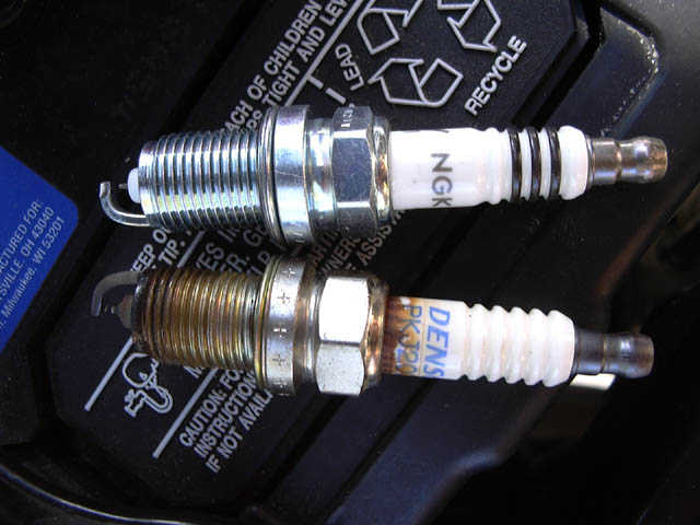

anywho...i just returned all three stuffs that i showed on the picture....
FYI, one of the spark plugs was mis-gapped by few points.....thanx for the info that recommend me to check them before installing..

FYI, my old plugs were not NGK platinum...
they were Denso Platinum PKJ20CR-M11

Glad to hear that your install went well. How did your stock plugs looked when you pulled them? How many miles did you have on your stock plugs when you changed them out?

stock plugs are either NGK double platinum (which you have there) or the Denso double platinum.
they're freaking expensive.. running around 10-12 bucks each... supposely they dont even reach the 110,000 miles (according to manual, thats when we should swap the plugs heh)
I just swapped my plugs out today too at ~44,000 miles. the plugs are fine but I think there is some minor melting from overheating.
bought the NGK gp-plantium ZFR6FGP for about 16 shipped for the set of 4.
