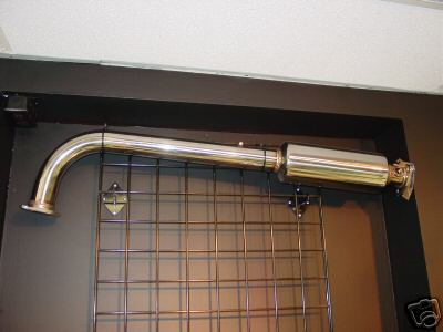

so which is better megan or hp racing or other ?
check this topseed one out!

Posts: 6,450
truthfully they're all the same. I think they're all the same diameter.. although I've seen one where the 'cat convertor' is smaller in size than others, not that it matters much.
as long as they have the 2 o2 bung you need, and as long as they fit perfectly.
I honestly wouldn't be surprise if they all came from the same manufacture in Taiwan that I've mentioned before..

thats exactly what i was saying cap, ive seen some where the piping is 2.25 or 2.5 and the cat itself is like not even 2 inch so i was asking if anyone knows any high flow cats like this and if some are bigger than some
Where can I find that one?
i work at a performance store in miami, and we were looking to order some and our supplier emailed us that pics, they said its $150 for downspeed, i think its worth it for topspeed but wanna compare it to others

Yeah that setup looks great. PM me when you get some I may be interested in it. Thanks.
