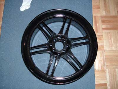

got mine coated for 200 dolars they use to be white
Finished product:

Oh yeah... and don't call a place and tell them you want silver. There's probably 450000 colors and gloss levels of powdercoat. Just call and find out if you can go through the book and pick one out. Of course the larger the shop you go to, the more likely they'll have it and not have to charge you a special order fee. The most important thing though is the gloss level. There's 65%, 85% and 105%
65 is basically flat, 85% is kind of shiny in the sun, and 105% is like a Harley Davidson shine... almost looks wet.
These are 85% and came out darker than I thought. I would suggest going 1 shade lighter than what you think looks good in the book... cuz the black tire will make it seem darker, as will the lighting outside vs. artificial lighting.
