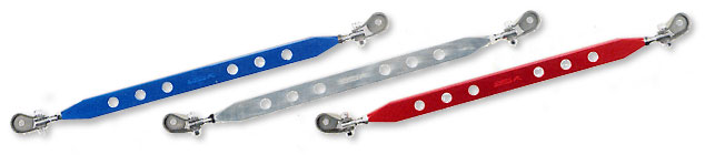

I'd assume is goes on the rear to prevent frame benting when turning, I see where I bolt it on but I wanted to make sure when if I loosen those bolts my axle doesn't fall off or somthing hehe.

So your talking about a rear lower Tie bar...
Some thing that looks like this
I'm pretty sure some one did a DIY for it, seach for Rear lower Tie bar.

Its this..

Yes...that will have to be the lower tie bar.

Undo the LCA bolt... As you undo it, get a screwdriver or something and stick it in the hole from the back side. That way the LCA doesn't fall out of the suspension mount. Do one side, put the bar endplate on and screw the bolt back in. You'll probably have to manuver the LCA around to get the bushing to line up straight. Then repeat for the other side.
Obviously, do this with the car Jacked up.
Note A: There is no rear "axle", the car is Front wheel drive
Note B: That bar doesn't do anything unless you've got a sway bar upgrade too.

I got it on, hurray! But in turn, I used a ghetto fab way. I had 4 jacks, 2 holding up my car and two hold up my LCAs.. Still had to use a strewdriver to straighten the hole out to re-fit the bolt in, wish I would have seen boilermaker1's way first. Away, thank you for listening to newbieness if there is such a word.
