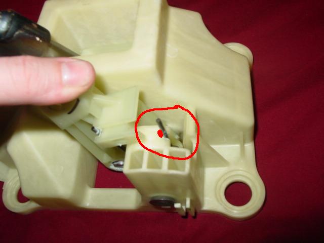

Not sure if anyone else has any side to side play in thier revo SS but it was bugging me to no end. So last night I took it apart and figured out why. See that gap? I had to push my shifter that far before the ap was taken up. I busted out my trusty set of files and filed down the stop for the spring. There is no more gap, so there is no more play. Hopefully no one else experienced this problem. But if so I hope this helps.

yes..the play annoys the crap out of me! everytime its in gear i wiggle it around an im like wtf whyyy. i'm going to have to try that...thanks!

beside that part, there's another part that can use some more work.. the joint down below...
the stock spring is also stronger... but its not easy to swap into.

Well the actual part that I filed down is below that pic. There is a stop about an inch lower. I couldn't get a good picture of it but figured people would see it when they pulled the shifter out. It didn't fix the problem 100% but about 95%.

Can you or did you take pic of the place where you filed it down.

The piece is supposed to move. thats why there is play. The problem is that there is a gap between when the stick moves and the spring moves and provides resistance. I thought about sticking something in the gap but it was easier to file down the stop. Also I didn't want whatever I placed in the gap to come out. Sorry I didn't get better pics of the place I filed down. But if you take it apart you'll see exactly where I am talking about. It's directly under the gap about an inch down. by filing down you allow the spring to touch the plastic at it's start. Hope I helped more than confused
Also as Cap explained..if you want to take the time to replace the spring...it would help tremendously. It would also give the shifter a nice tighter feel.

can you post another pic just not so close, i cant tell what im looking at. Thanks

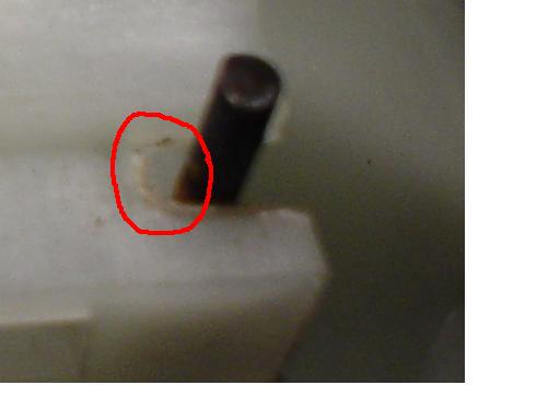

You should be able to figure it out from this pic. I marked where you need to file to get the gap out. Let me know if anyone needs more or better pics.

Could you file it down while it was installed? I hate to take my Revo totally out again, since I was just in there....

I guess you could. I took it all the way off cause I wasn't sure what was causing it at first. Of course you could just live with the play...I mean it's not THAT bad. I wanted to find a way to reinforce the plastic where the spring meets it...I thing it has worn away with use. I was thinking of cutting and super glueing a rubber band piece in there. or even cutting a small washer in half and mounting it.

HAVE no fear pheaton is here!!! Ok guys. . here is a pic that will help you see it a little bit better. Instructions are as follows:
Before you begin, examine the assembly. Use the other posted pics to identify the area that we are talking about. I circled the area that needs a slight trim to get rid of any play. .
1. Pull the spring end toward you to pull it out of the slot and push the spring end to the right out of the way, so it's on the outside of it's resting spot circled in red.. (like shown in the picture). It should stay there by it self. .
If you have to, pull the shifting bar to the left, in the neutral position. This will make it easier to grab hold of the spring to move it out of the way.
2. Now, have at the lower slot. I used some needle nose plyers to grab hold of little chunks of plastic to tear it away and finished by sanding/smoothing it down with the fingernail file on a pair of nail clippers. Don't tear off more plastic than you need for the spring to lay flat and do your best to preserve the shape of the slot.
HOPE THIS HELPS!!

wow! thanks. One small question though; roughly how much did you have to file away?

why did you tear away wear the spring doesn't rest anymore? Im a little confused, but am interested in doing this. Can you give me just a little more explanation? BTW, great pic!

Very little has to be filed away. I just used some needle nose pliers and grabbed little peices of it. Just check it after you remove a little bit and keep doing that until you have it where you want it. But it's not much at all.
and fuledya. . I just moved the sping to the side so that it was out of the way, so that I could shave off some plastic. .

You need to file away however much gap you have. If you have .5 cm of gap..then file away .5cm of stop. the gap is pretty small..like seriously the distance between these two lines ||. Your could be a little less or a little more though. Hope this helps.
