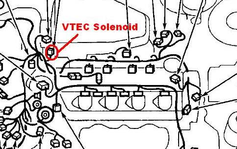

i was looking through my text book the other day, and came upon a picture of a EGR valve on a GM vehicle...
so i remembered someone whol told me we had a VTEC controller, and that controller looked a bit like that.. and low and behold...
i think that is maybe a egr valve, and not a vtec controller like others claimed.... any ideas?

Old Sep 15, 2003
TeLLy's Avatar
Yes, it's an Acura EL
iTrader: (23)
Posts: 8,248
VTEC solenoid is sorta behind the engine.
Old Sep 15, 2003
TeLLy's Avatar
iTrader: (23)
Posts: 8,248
See?

Yep. It's an EGR valve. I found it here: Click me

oh man whoever said that was the VTEC solenoid... *smack*
its weird but last I check I dont think the DX/LX have it. probably due to the fact that the DX/LX cat is right near the exhaust manifold, and it probably puts out less emission than the EX.
yeah the EGR valve is the Exhaust Gas Recirculation system's main emission control unit. basically it allows a part of the exhaust emission from the exhaust manifold to go back to the intake manifold. I believe it's usually located near the intake manifold.. but in our case.. its between them.
so in a sense it does have to do with temperature.. cuz by recirculating, it reduces combustion temp. and helps control the amount of oxides of nitrogen.
I believe the 98-02 Accords have some problems with these.. and quite a few people had to replace the EGR valve.
and that's that. another modern vehicle emission control component.

damn I love that diagram it expalins it all!

anybody found the egr on their lx?
Old Sep 16, 2003
CapYoda's Avatar
Escaped Convict
iTrader: (30)
Posts: 6,450
Rep Power: 367
nah there isn't one.
service manual diagram shows that there isn't one.

i could be wrong but that big black wire coming from the top of it looks like its going to the spark plugs. could it be the ignition coil pack? because it doesnt seem like the spark plugs are gettin their juice anyother way.

no er.. its the egr valve like we said.
if u remove the ignition coil cover you'll see where its coming from.
plus in the first pic, do u see the wire coming out of the ignition coil cover? right above the very wire going into the cover? thats where its coming from.
