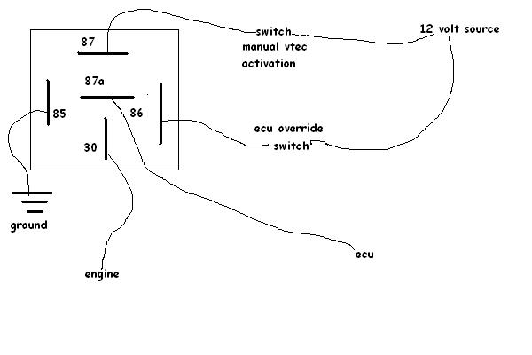

a non-risky non ghetto way would be to use a relay and 2 switches.
a relay has 5 positions on it, 87A (signal sent when relay isnt powered), 87 (signal sent when relay is powered), 85 and 86 (the 2 you must give power and ground to to activate the relay, the order nor side nor which is switch doesnt matter), and 30, the signal sent.
youd want to take the stock wire, and take one side of the wire, and run it to 30. the other side youd hook up to 87a. now youd take a switched 12v signal and route it to 87. you then ground either 85 or 86, and hook up a diff switched 12v signal to the one that isnt grounded.
your switch hooked up to 85 or 86 would then override the stock vtec control by the ecu
your switch hooked to 87 would then let you turn vtec on at your leisure.
now your manual vtec engagement switch wont work unless the vtec override switch is on
lets see if i can draw a diagram on paintbrush
Name:	vtec override.jpg
