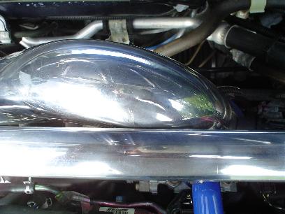

Does anyone else have this problem? I just mounted a cold air intake and a front strut bar and they rub at the bend where the CAI tubing exits the throttle body. I was thinking of buying some colored vinyl tubing similar to what was included in the kit but of a larger diameter to fit over the strut bar where it is rubbing . Does any one else have this problem or know of a more creative solution to fix it ? Thanks to all that reply, Jason

ya........everybody has that problem when they have a generic brand strut bar.........you got to get rid of that strut bar......or if you want to keep it toss the CAI......but if you want the CAI you got to go Neuspeed or DC Sports.......I think they're the only guys that make a strut bar for our cars that'll be compatible with a CAI

i had the same issue, 1, i put a peice of weather stripping on it, to pad it, but it wears thru, what you have to do is tilt/angel the bar outwards via the parts you tighten so its stright, so it doesnt hit, if you need further help, pm or email me

EVERYONE needs to stop saying that, all you have to do is angle the bar, and it will fit with any intake, i have pictures of it, and other members have done this also, you dont need to buy a neuspeed, or dc, any of them will work

um, look at my ride...its been posted how to fix...pm me if you have More questions

Its not good for the engine for it to rub! and its not rubbing when you start the car its more like banging. You must bend the brackets and angle the bar foward

My strut Bar looks the same as cdmx's, I'll try turning the bar so it's buldge or "arch" faces forward instead of up as in his pics. Thank you for your quick reply's everyone hopefully this will slove my problem.

Well, it fixed my problem and I have no shame in saying yes I purchased the strut bar from Ebay and it is of good quality and it cost a whopping $14.50 plus shipping!! lol
