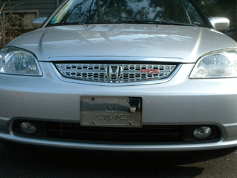

Originally posted by CivicHX01
i installed mine without the radiator cover... had it over a year now and have had no problems so far
* CivicHX01 knocks on wood
u know what the problem is.. not the grill... HOLE that u can see between the HOOD
Old Jul 12, 2003
CivicHX01's Avatar
Posts: 3,101
From: Los Angeles, CA
there was an entire thread on that gap between the altezza grille and the hood... we came to the conclusion that its normal and you get used to it... only noticable if your looking real low...
Haha... you went to the trouble of blurring out your liscense plate, but not the reflection? 4SXG275
Originally posted by jameswyatt
have anyone tried to cut out the mess and put in metal mess to match the ground effects.
First of all, the word is mesH. If you wanted to do that, you might as well just have the mesh part painted a different color. You should know there are several kits that have the grille built in.
the gap is normal??? WHERES MY GAP ? HMMMMMMMMMMMMM?
you have sedan radiator cover though CivicHX01 doesnt have it on.
your grill looks good..
you have a sedan and the grille was originally designed for the sedan...
