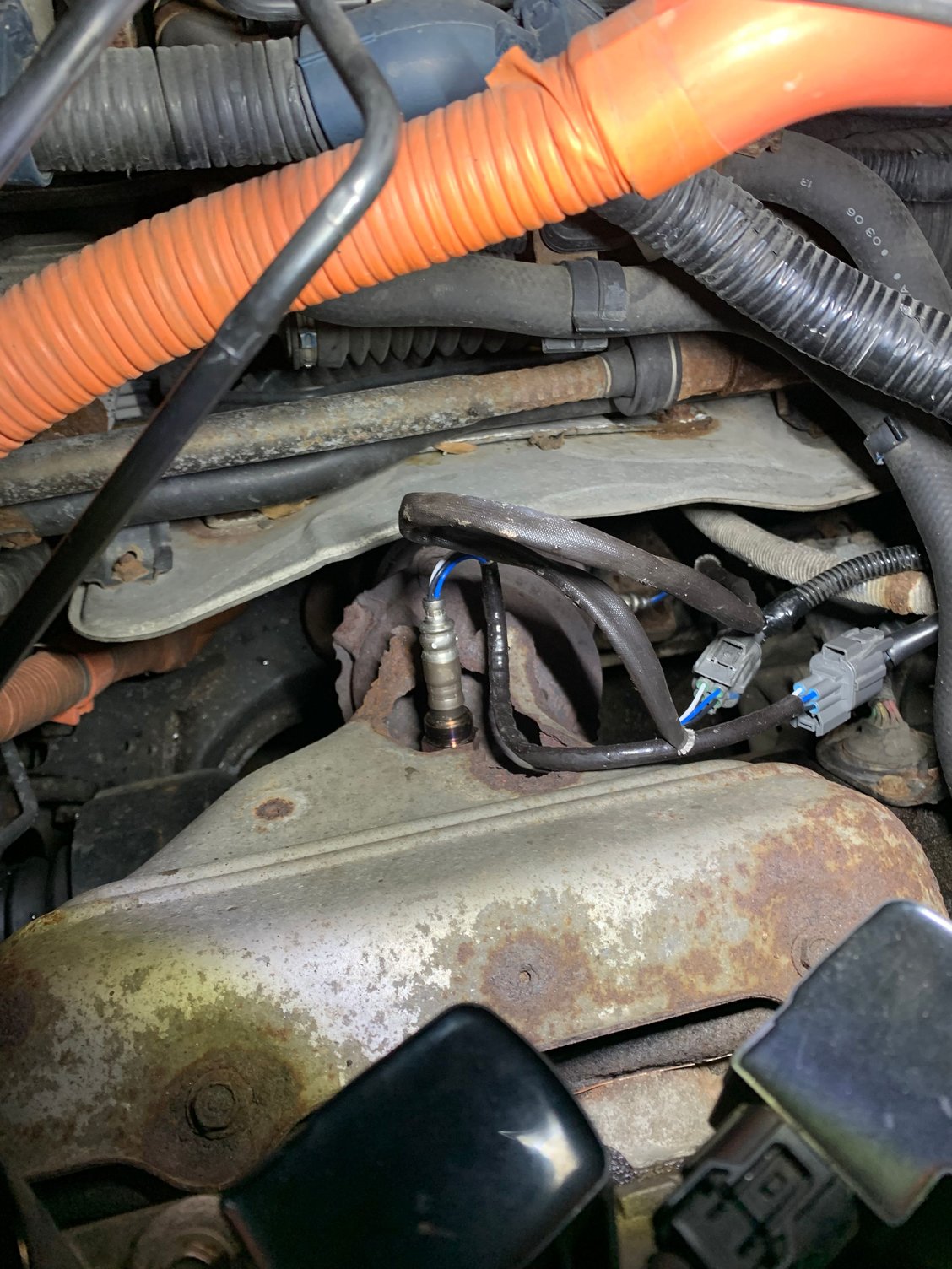

2003 Honda civic hybrid can’t find bank one sensor 3 location.I have looked all over the tail pipes but can only find 2 o2 sensors.I currently have a check engine light for these 2 codes p0147 and p1130.I have already bought the sensor but can’t find the location of it.

I have exactly zero experience with the hybrids, but a parts diagram is showing one sensor on the header (which I see in your picture) and then two more underneath on the second catalytic converter.

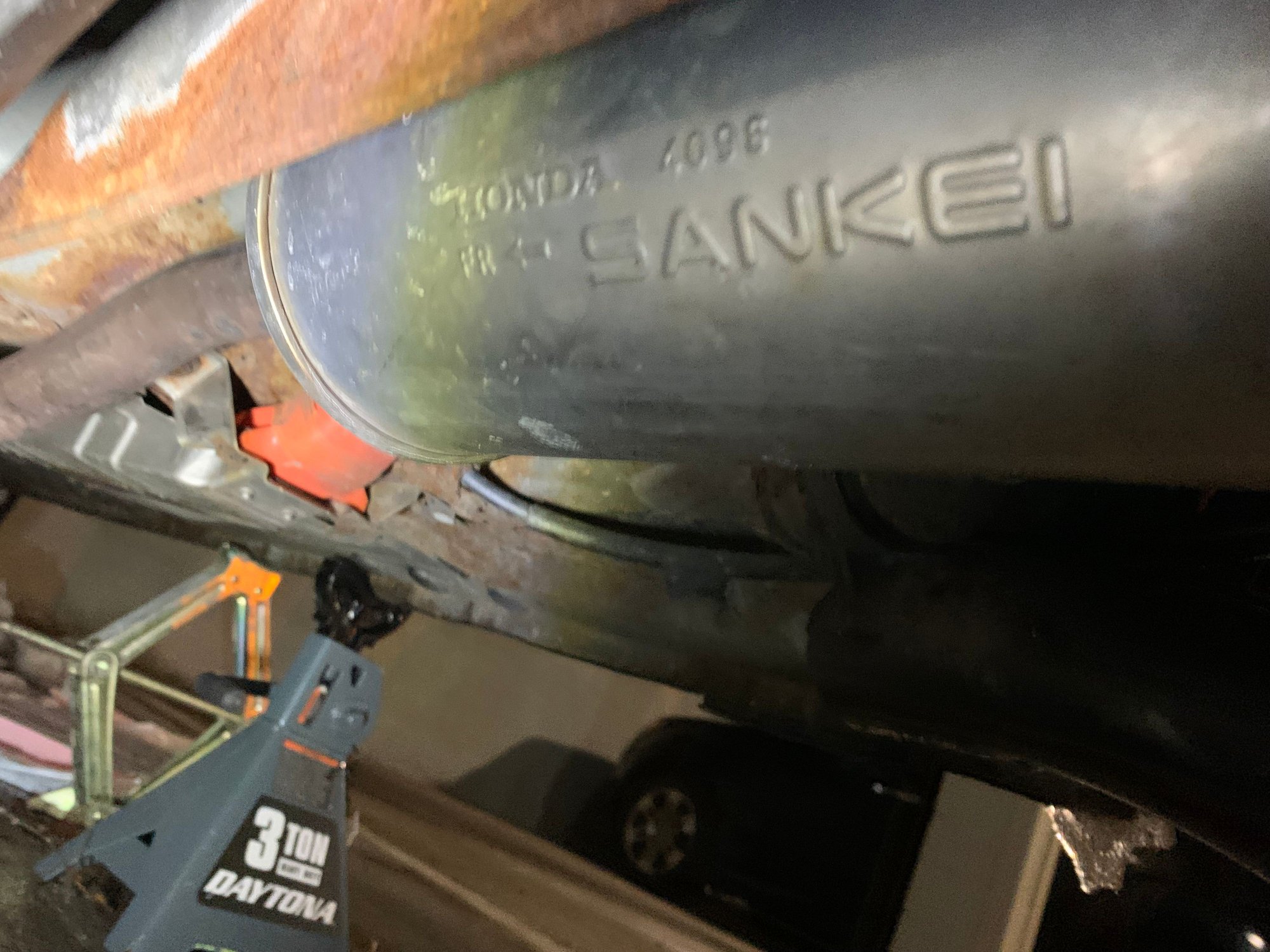

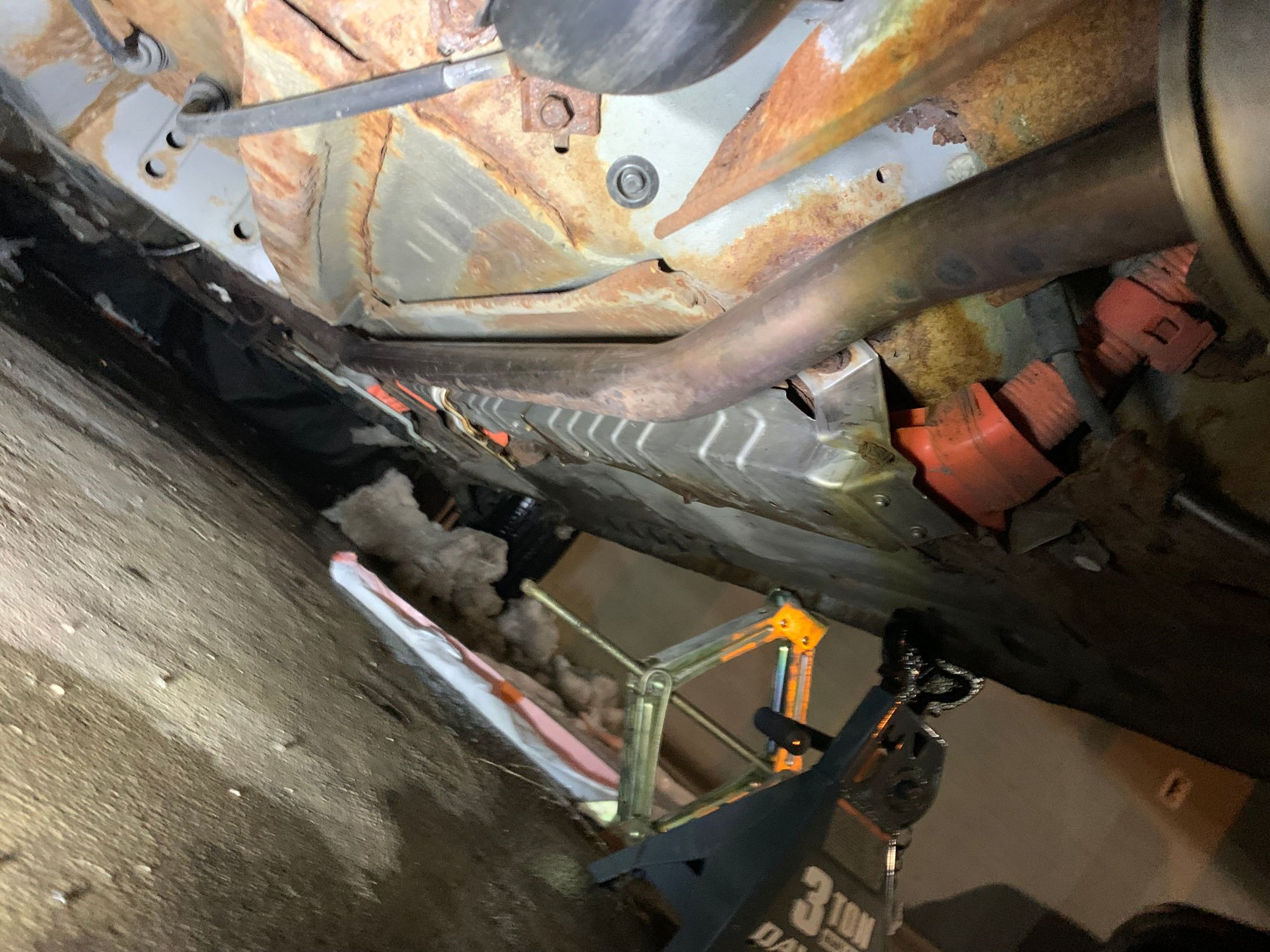

Your second/third picture are from the back of the car, correct?
Diagrams show one cat integrated into the exhaust manifold, then the second in the down pipe right after.
yes second and third picture are from back of the car I don’t see one after the Down pipe I’ll check again later today and send more pictures.Im curious what happened to it.
