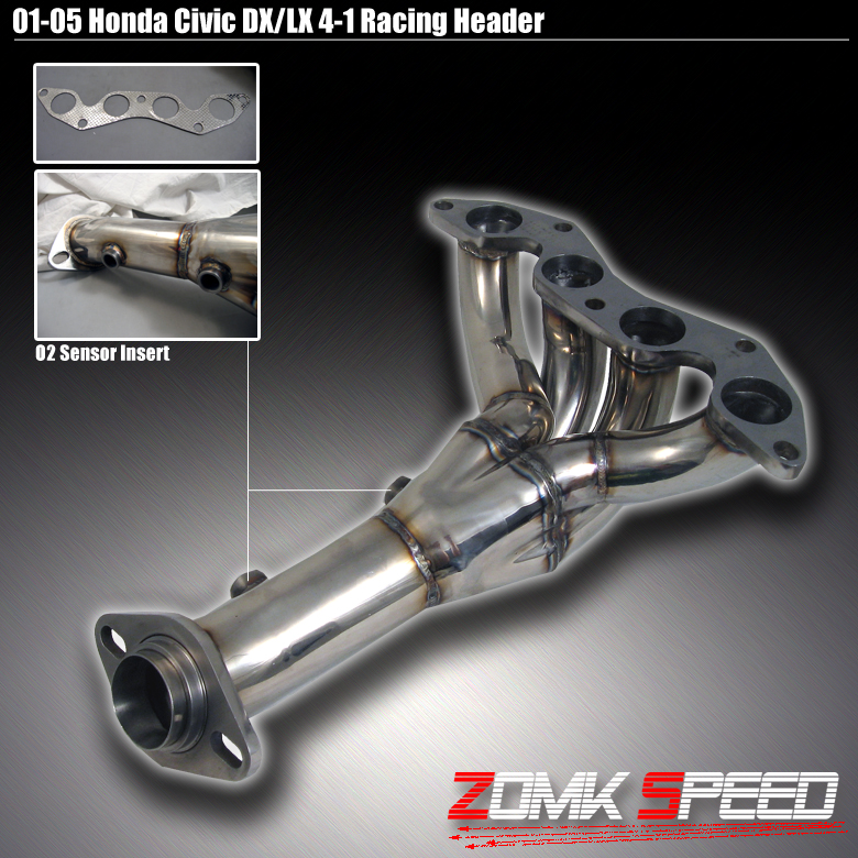

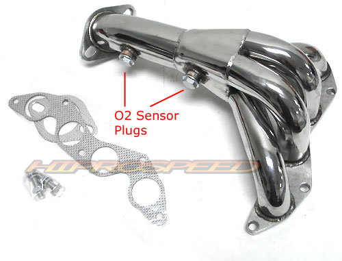

Hey fellaz, chek dis one out and tell me if it's worth it to buy or not. I still have stock piping btw!!! i probably will be gettin the rest of the catback after trying this ones out!! ANY REPLY WILL BE APRECIATED!!
WHICH ONE IS BETTER???
what is the difference between cheap headers like all of the above and expensive headers??? is there anything you should look at before buying headers?

Re: Wut u think about it???
I see that I need to add some more info into the FAQ.
First, I think that all three of thoes headers are the same exact header.
Second- consider if you want to loose a cat. Consider how many exhaust systems are out there that specifically bolt up to a LX/DX/HX header- I cant remmeber seeing many at all. If you try to hook up an ex catback, your going to need to take a trip to the muffler shop and get a connecting pipe specially made to connect the "EX cat back" connection point to the "LX header back" connection point- a differnce of about two feet. This will include two gaskets, flanges and the pipe itself.
What to look for in a header- you want to find the optimal sized piping running from each exhaust port- there are a lot of headers out there that use different diameter pipes. For the optimal size, I dont know off the top of my head- too small is restrictive, and too big is just too big- loss of backpressure. Look at the welds- do they look like crap and will they crack down the road? Basically look at the build quality. Look at how all four pipes running off the exhaust ports merge- does it look restrictive, or is it going to flow smoothly? There are mainly two coatings out there- stainless and ceramic. People say one is better over the other, so thats up to you.
See, how the pipes add up- looks like it could be more free flowing if you ask me.

So wut you're basically saing is to get: ex headers, ex bolt-on downpipe extend my cables and connect that to the rest of my exaust?? but wouldnt that still throw me codes?
