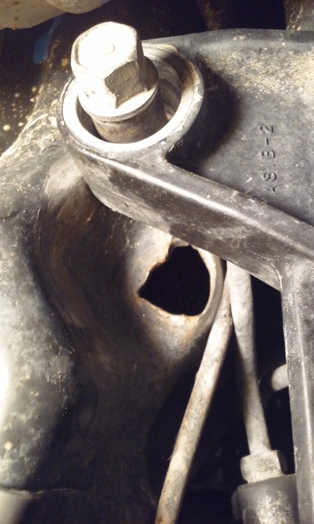

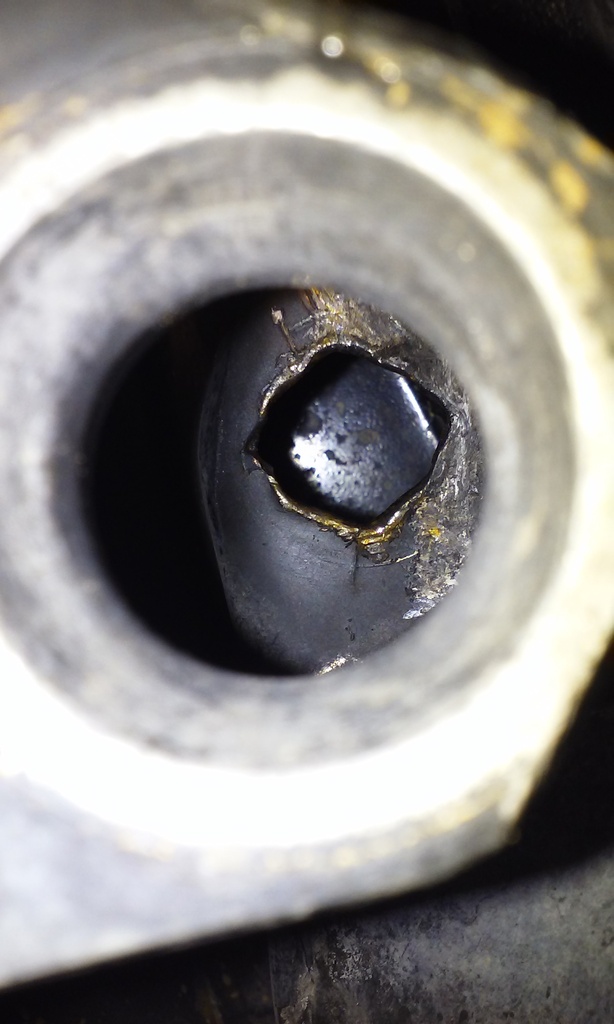

Those are the bolt holes that are supposed to bolt the rack to the frame The bolts are just sitting in the rack but not bolting anything down. There was no rubber in the round bracket that holds the rack in place on the driver side. Also the plate that you are supposed to remove before getting to the rack (I don't know if that helps secure it or just protects it??), was missing entirely... So basically the tie rods and the steering column are the only thing holding the rack and pinion in on this car. The rack can move left and right at least 4 inches before it ever starts operating to move the tires.
I don't feel safe letting my lil brother drive this car anymore. I could try to jerry rig it by welding nuts over the holes where the bolts are supposed to secure the rack, but I wouldn't trust it. It would basically be a band-aid to try and sell it but then again, I feel that is sort of shady. Basically I want to know if this is repairable and how to do so properly, or if we should just try and part the car out or what.

You could price the rack, the big support beam (or subframe, whatever you want to call it) and all that out of a recycle yard, add in a ton of labor to change it out, and a wheel alignment after it's all bolted in.....
This situation looks unusual to me...... Are you in the rust belt or are you in the desert?
I've seen the big beams rusted out on a few of the older cars (rust/salt belt here) but yours appears to have wasted the rubber bushings (desert, high heat?), which leads to severe stress on attachment points (ripped fasteners out of the steel), yet you say you have a foot of snow on the ground. Where are you?
If you are not in the rust belt, that might be DIY fixable somewhat reasonably, but you need to inspect everything else to find what else needs attention to keep it safe. IMO in the rust belt the car would probably be scrap.

I don't know if the metal that the rack actually bolts into is replaceable (where the bolts ripped out of) or if I need to weld some nuts up there or what. Then I'll still have to go find the other metal crossmember or w/e it's called.
I honestly want to just offer my pops $200 for the car as is and then part it out or offer to haul it down to the scrap yard and charge him $50 for that. I wouldn't trust even after I band-aid it.
