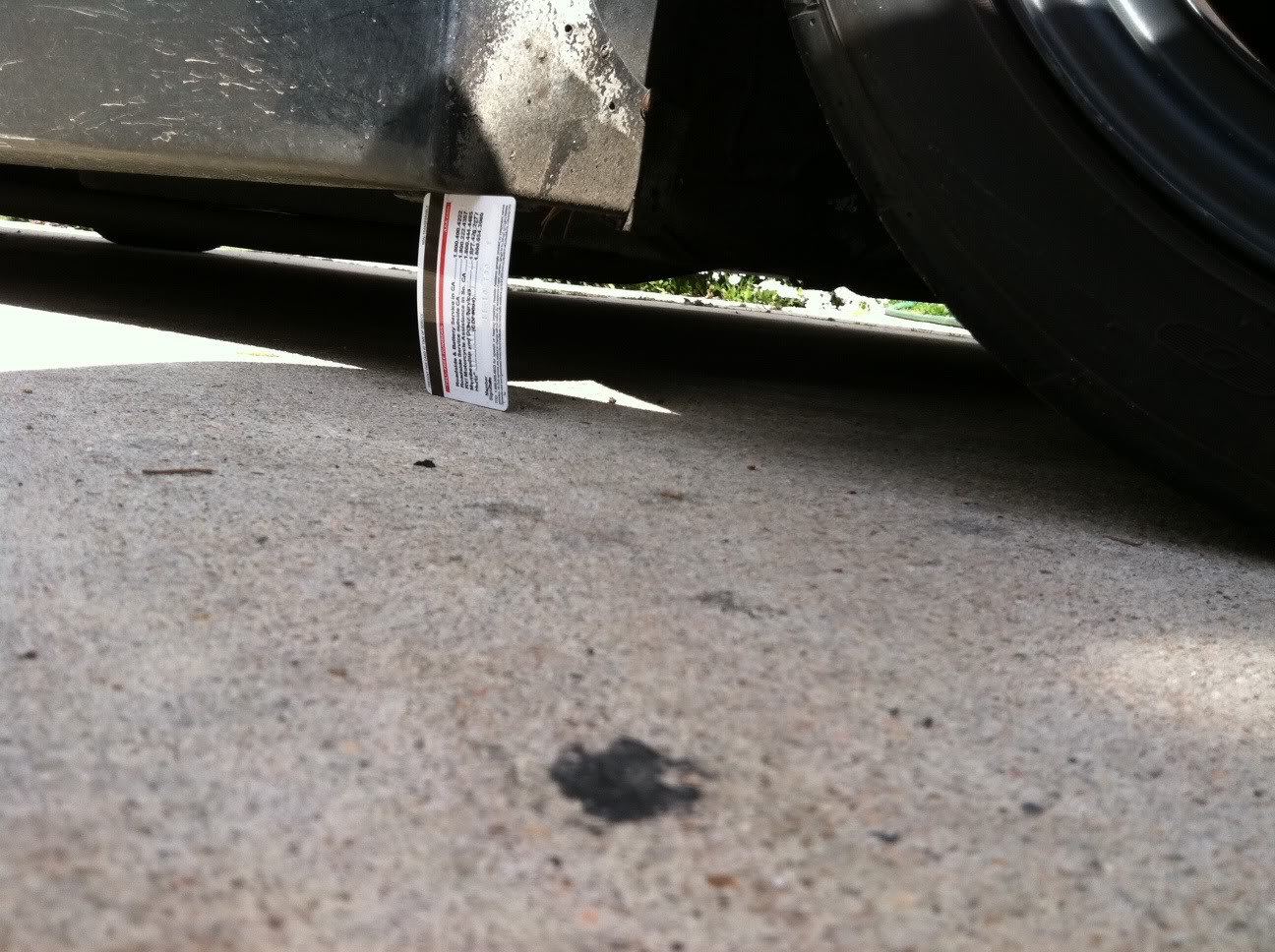

i cant clear ****.
i can BARLY get my 1.5 ton aluminum low pro jack in there.

^^ Good luck changing a flat tire. lol
