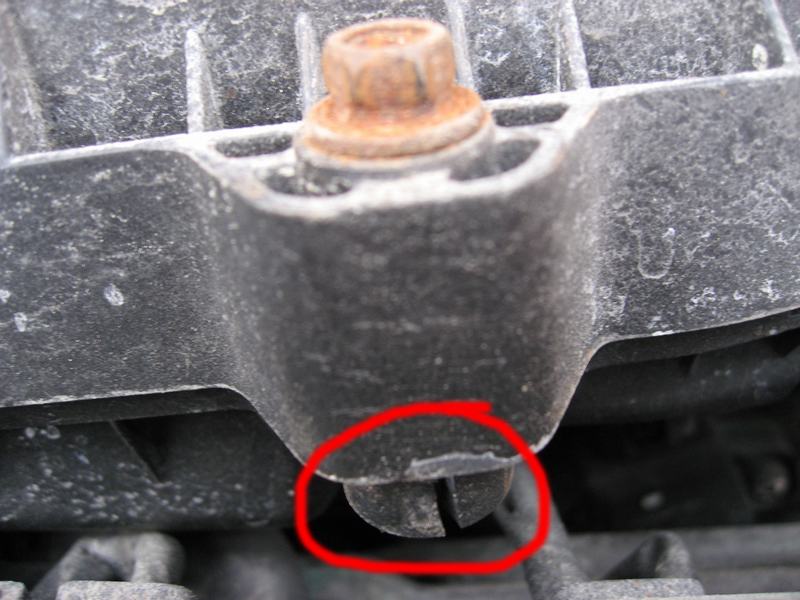

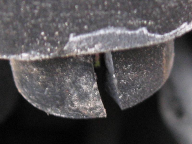

I tried changing my air filter on my 2001 civic and over-tightened one bolt and it cracked the box. Now I can't get the bolt out!! It just spins and doesn't rise.
I've read other posts on this and someone mentioned to try prying up the bolt with a flat tip screwdriver and turning the bolt. I'll probably try that. Any other ideas?
Also, if I do get the bolt out, should I replace the whole air filter box or is it fine with a little crack where the bolt is? Maybe some Lock Tight for plastic would work??
Pictures are attached.

Those bolt threads are exposed to the elements underneath and rust easily. There is a bulletin about the cracking box on early models but they never really changed the design & the bolts still rust and get super tight on all years of 7th gens.
There are threaded inserts in the lower section that the bolts thread into, you may be able to grasp the cracked portion with slip joint pliers and hold it tight enough to get the bolt out of the insert.
Every time I take mine off I put teflon based oil on the threads of each bolt and it helps out some.

You might try taking all the other bolts loose and try lifting the cover up leaving the problem bolt as is, the insert will come up still on the bolt.
If not,
Yes, use the pliers to close up the crack (it could break the rest of the way btw) and continue to hold it tight while attempting to remove the bolt. The inserts are round metal sleeves with threads on the inside for the bolt and grippy surface on outside to hold in the plastic they are molded into.
My guess is the insert is spinning and when you grip it you are trying to hold the insert from turning and remove the bolt.
