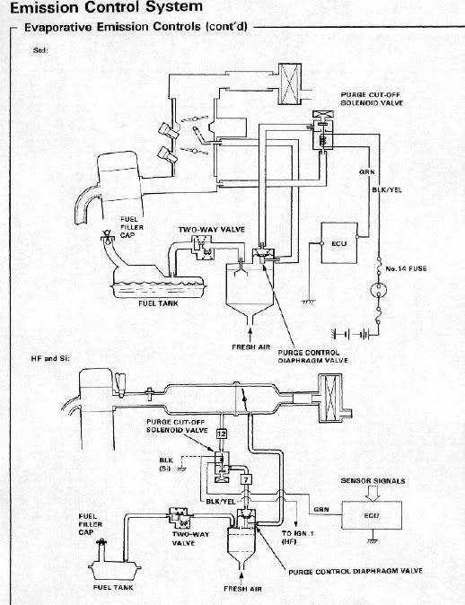

It's for the EVAP system. See part 1 here:
http://www.hondaautomotiveparts.com/...+TWO-WAY+VALVE

When fuels vapor pressure in the fuel tank is higher than the set value on the two way valve, the valve opens and regulates the flow of fuel vapor to the canister (filter) near the engine.
