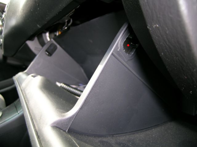

i saw the stops but how do you remove them? pry them out or what i didnt feel like breaking them off so i stopped yesterday only the right one could i get to move
Old Aug 7, 2006
  #44
ctx66's Avatar
Posts: 935
Rep Power: 286
ctx66 will become famous soon enoughctx66 will become famous soon enough
You push those stops inward, from the outside of the glovebox.
Push with your finger where the red dot is
