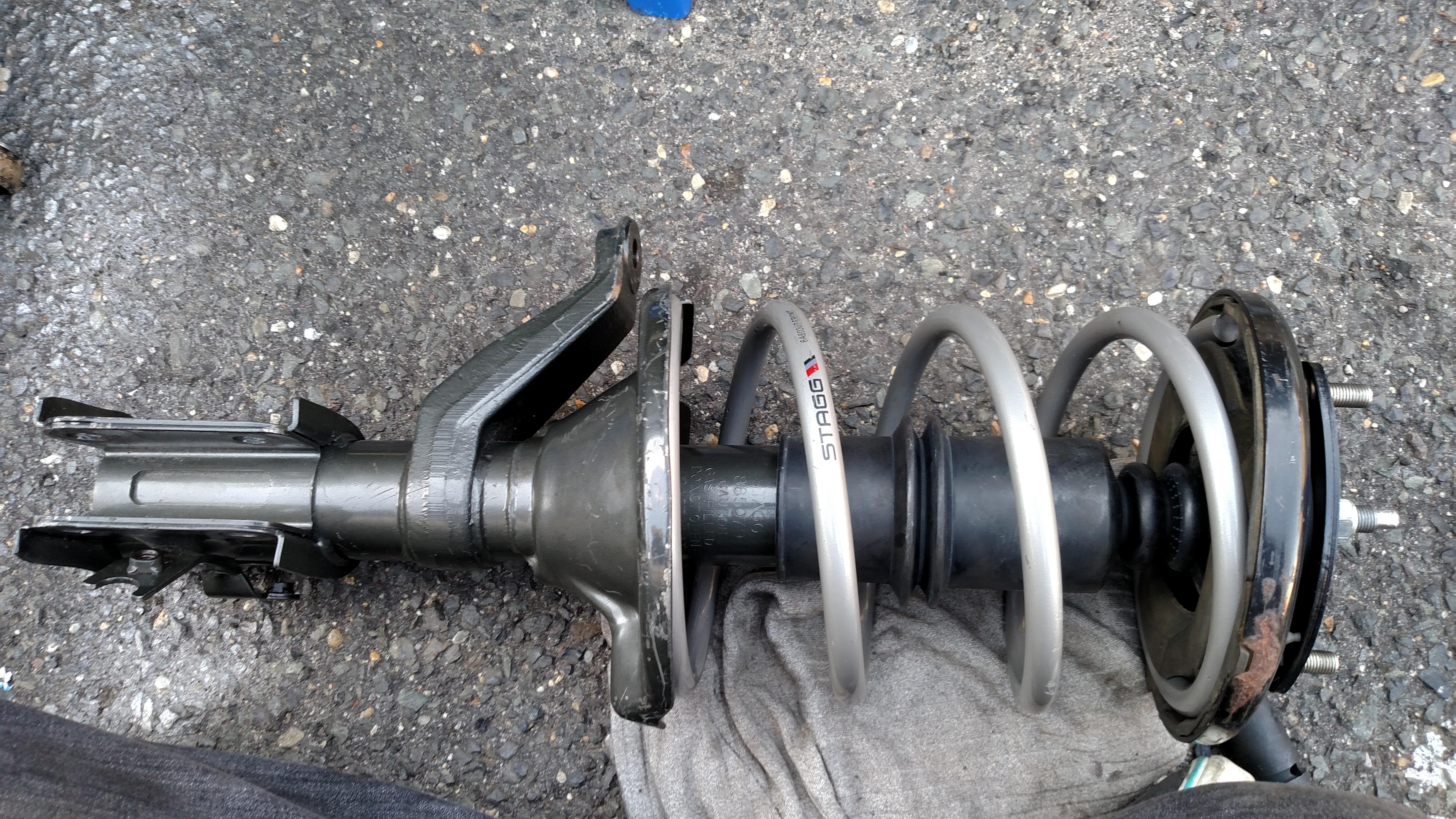

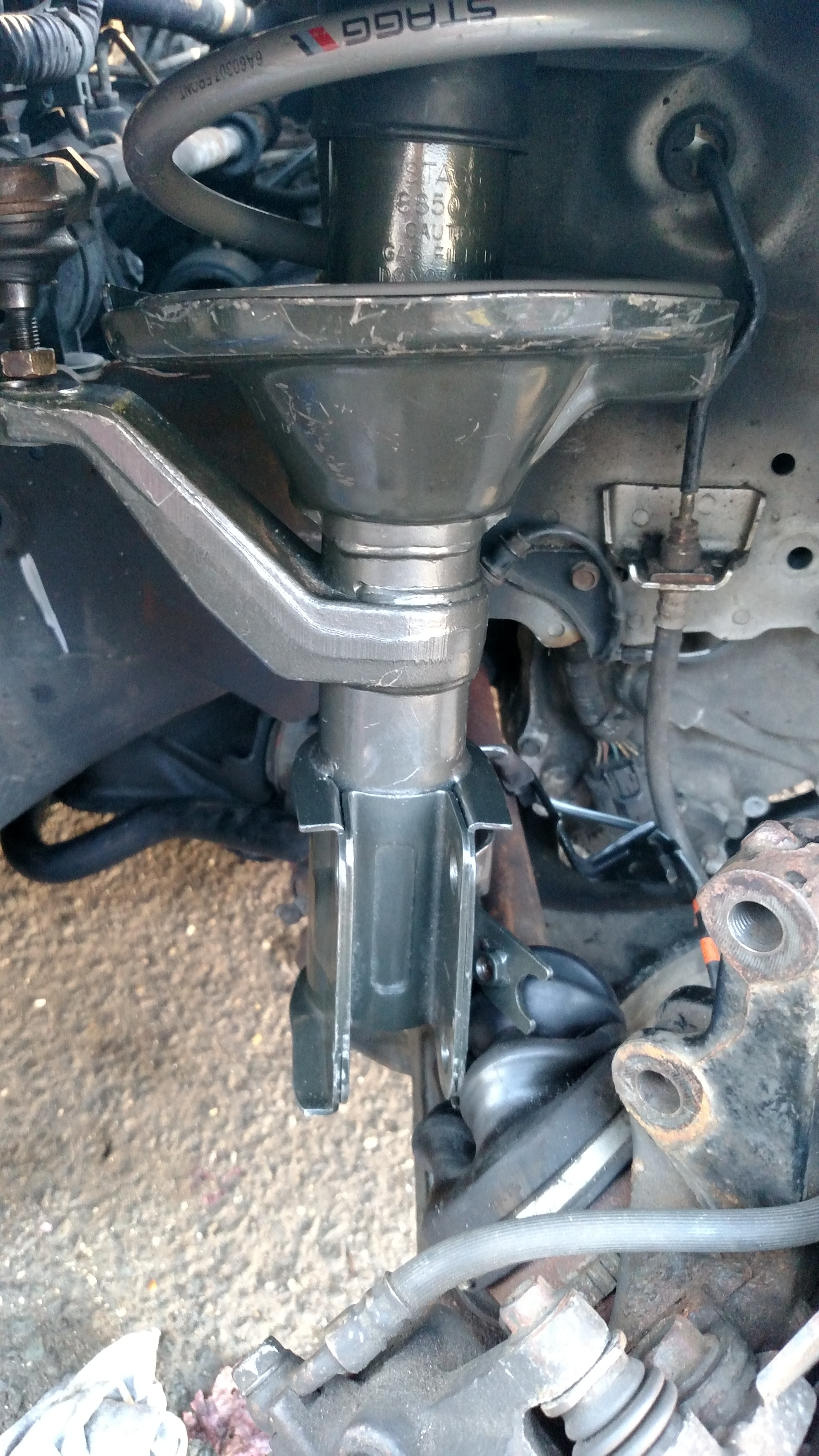

Damn I put the jack exactly where you said not to put it. Now looks like my strut doesn't fit. How can aliviate the situation? Put pressure back into the control arm? Also is my spring upside down or is that the right way and I ask that just because the letters are upside down. One last thing. The top hat should say R since I was working on the passenger front side correct?
