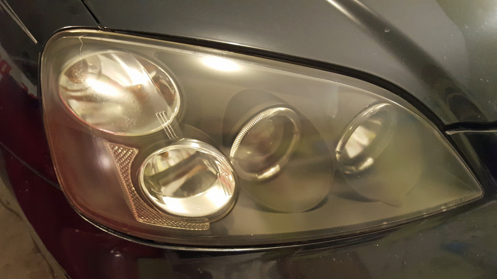

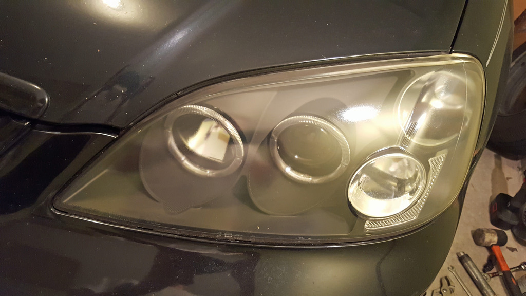

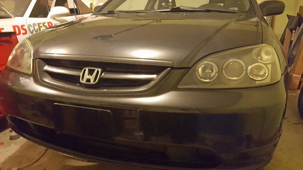

After polishing my headlights, it always hazed quite fast...
that's when xriceboyx gave the the crucial tip:
after polishing, just clear coat the headlight.
Don't forget to polish the clear coat, or the roughness will make the light scatter too much.
mine have been clear so far for a month, before it would haze back in a week.
pre-polishing the clear coat, so you can notice the roughness
