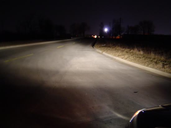

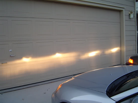

all of those aftermarket lights do not have the proper beam pattern to drive with. instead of being smooth with a brighter light at the top, many of them are too focused or have dark spots in the beam. for example here is the 01 civic reflector with halogen, compared to a tyc projector with halogen.
tyc projector with h1 halogen bulb

oem civic reflector with h4 halogen

Yes I see what your talking about. That is a big difference!

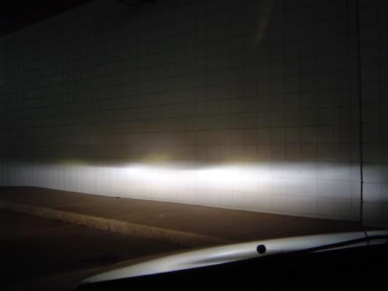

well, no. aftermarket oem style reflector lights are just as bad. if you want that style, better to open the factory honda light and paint the trim piece black yourself while keeping the better reflector. for example here is what the oem honda reflector looks like. notice they are very bright and have excellent spread and beam distribution (wide hotspot).

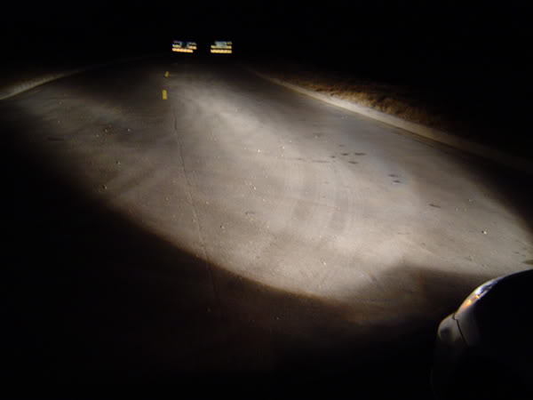

now look at the aftermarket 01-03 oem style lights (left side) with a tiny center hotspot and terrible beam pattern with too much foreground and very little width. right side is oem honda 92 accord headlights.

Those illustrations helps a lot gearbox.
