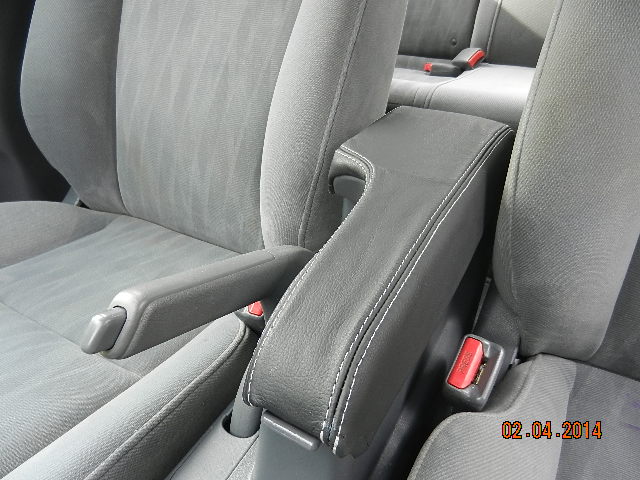

Wrapped center armrest
ID:	86370The old center armrest upholstery was shot so I ordered a leather one from ebay, $28. Pulled the old one off and the cleaned off the deteriorating foam that was left. Used some one sided glued weather stripping for the new pad and then used a spray adhesive for the leather wrap. Could not use staples for the wrap because the plastic was to hard. Anyway I would give myself a B for the diy.

good enough for me, you telling how you did, not asking how to do

Looks like an A in the pic. You could make a DIY.
