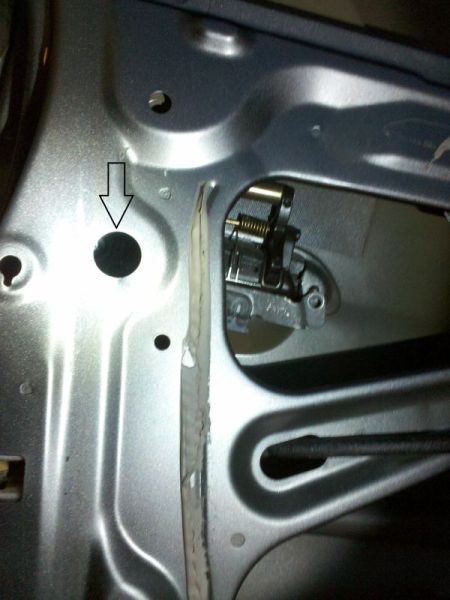

After removing the inner door panel you'll have access to the inside of the door:
If you look in that hole where the arrow is pointing you'll see the inside of the lock and door handle.

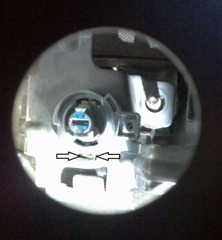

Looking through that hole you'll see a small gap attached to the top of the lock (where the two arrows are pointing):

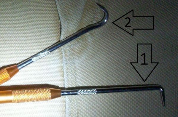

I purchased two hook tools at Harbor Freight (~$5) a while back for use in doing routine valve clearances on my motorcycle, I used these same tools in the next step:

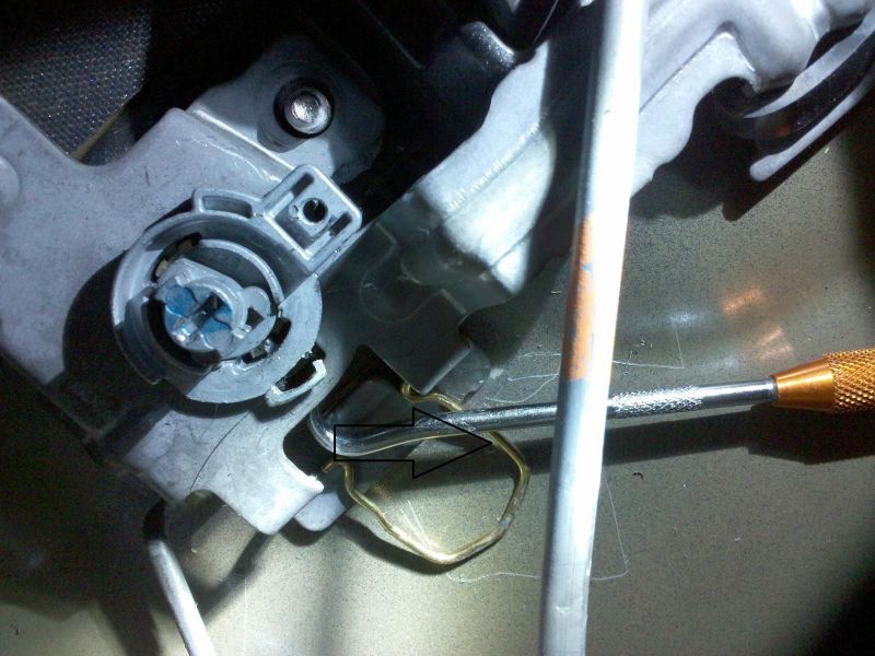

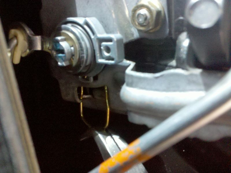

First I pushed hook #1 into the above gap, the straight tool forced the small gold clip outwards. Then I used #2 to reach under the gray metal and hook onto the clip. Once hooked I pulled straight out and removed the clip easily:

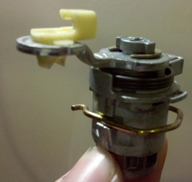

Once done the lock will slide right out (toward the interior of the door.) I put the clip back on the lock so that you can see where on the lock it clips to when it is installed:
Install is the reverse of removal, and installation of the clip will look something like this:

This post is awesome. The clip is visible but you can't see enough to figure out how to remove it without instructions. I'd only add that, rather than using hooks, you can loosen the clips by hand.
You simply reach down behind the bracket to the top of the lock cylinder. There, you'll be able to feel the two top ends of the clip. By pushing down on one end then the other from the top, you'll soon have the clip hanging down. You can then reach the lower part of the clip with tools.
Reinstalling the clip partially by hand also worked from me. I found that if I tried to reinstall with pliers I couldn't get the clip in the correct groove very easily. If you wiggle it up there by hand you can feel around until the clip is in the correct groove and then push the clip on part way. Then, you can use pliers to finish installing the clip.

That slot at the bottom of the lock? Blocked by that metal contraption that is behind the door handle. So I couldn't push anything into it to get the clip down to hook it. I started at 5:30 in the evening. I gave up shortly after 9pm and went to Autozone where the guys there proceeded to help me ghetto work it with a 2' long Phillips and some 11" needle nose pliers. They were out of the hooks. Managed to push the C clip down enough to grab it at the bottom with the pliers. Finished the job there in the parking lot about 15 minutes after they'd closed and the guys went home.
