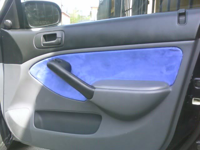

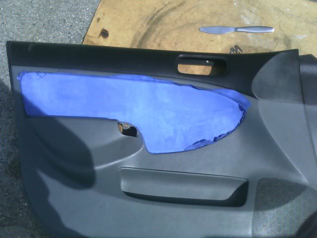

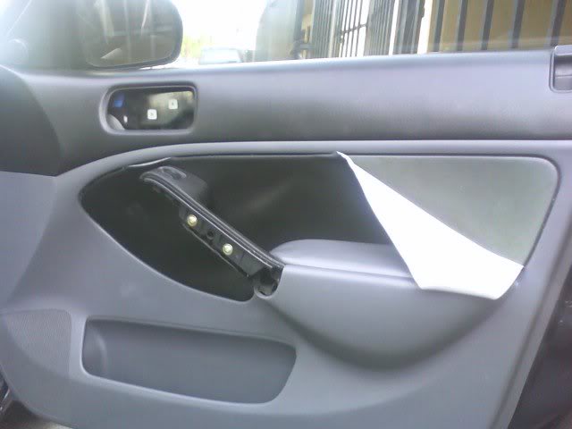

Hey guys, how's everyone doing. I bought my 2005 Honda Civic LX SE 2 weeks ago and the panel fabric was coming apart so I decided to take on this project. I actually put on the new fabric without taking the door apart, only the window lock section. Both doors and the middle armrest took 3 hours, not bad if you ask me.

Originally Posted by civicchick2001
they look awesome! how did you do this with the doors on? I'm seriously considering this now..
It was actually extremely easy, and this is considering I'm 17 years old and was able to do this without a problem.
First of all, photo credits go to: EggRollBandit05, I just edited them.
I have a 2005 Honda Civic LX SE, so I'm not sure if your car will be the same, but I'll tell you how I did it.
I removed the screw from the power window handle, which is covered by a small plastic piece that you can just lift with your figures.
After that I pried it open, and exposed the cables, and disconnected the window power connector, and put the cover aside.
Now there is also a second plastic piece behind the power connector that just lifts up, so lift it and put it aside.
Now there are 2 screws where the power connector is, so I removed them also.
Then I popped the plastic piece that the connector is on just enough to be able to take the old fabric out and put the new one on. Should be 3 plastic pieces, you need force and actually have to break the pieces that hold it, but don't worry, a little crazy glue and it's good as new.
Then I glued on the new fabric with M3 and slowly put it on, and got no wrinkles
Then I put everything back on.
