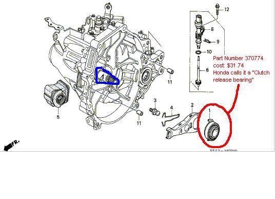

Ok..i dunno how much help this will be if any...i'm just throwing it out there.
my tranny was messed up a few weeks ago, but i've had it repaired since then. when i went to pick it up...the owner of the shop showed me my old transmission.
he showed me how the part that i highlighted in blue is what was causing my problem. this part had been wore down a lot and i could feel it very rough and i could feel a flat part. you could even see where it was scratched up cuz the bearing that slides on it wasn't slinding smoothly.

that is the input shaft and the throwout bearing.

just wanted to mention that the input shaft was messed up too...it wasn't just the bearing..the bearing had an effect on the shaft by wearing it and making it rough and so that had to be fixed as well...
