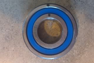

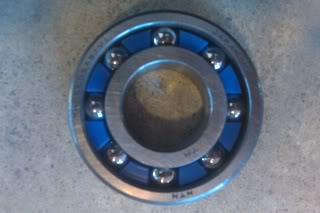

Old Aug 4, 2011
  #199
wade623's Avatar
Joined: May 2011
Posts: 102
wade623 is an unknown quantity at this point
Re: DIY: Diagnose manual Tranny Noises (and save some $$$)
today i found a solution to the problem. i found someone that does custom bearings and does thier own cnc machining and also does most of the bearings for nascar. i got a differnt retainer for the bearing that is made out of a better material so it shouldnt break like the plastic that it was originally made with
honda input shaft bearing 26x58x15 (part # 91002-PS0-013) with custom retainer
if anybody is interested in getting one you can pm me
pm'd
is it just the retainer you had made? or the whole bearing?
its just the retainer i bought the bearing from honda then i got the retainer for it
this is the original one for it
(this is the piece that breaks in the bearing)
