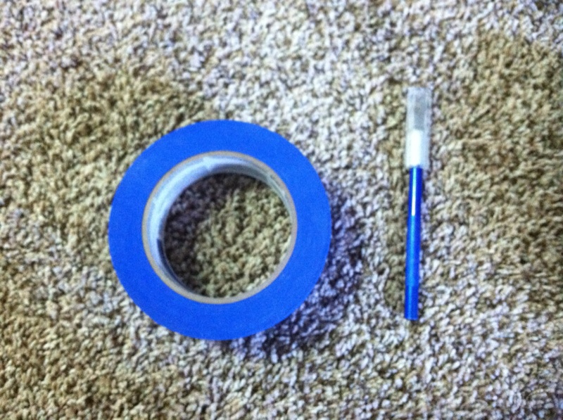

Supplies:
**Painters tape (not cheap Harbor Fright tape). I use Scott's blue painters tape.
**X-Acto blade or box cutter with new sharp blade.

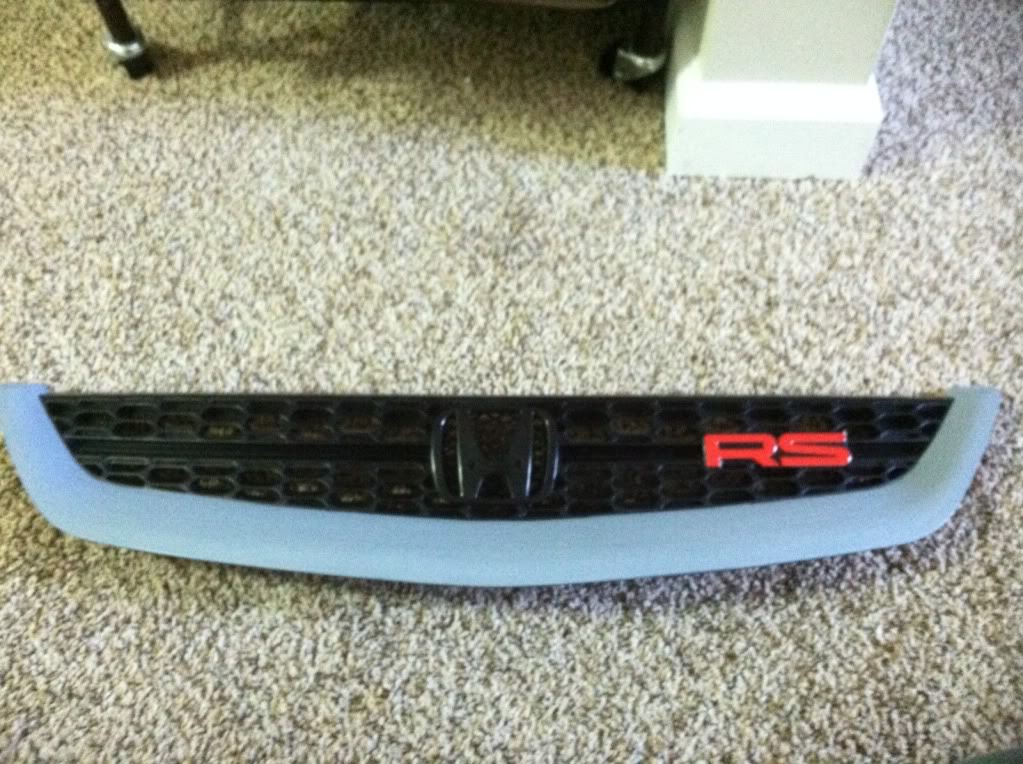

1.) start by deciding what you want to paint. I'm painting my grille so I only want the lip at the bottom and on the sides to match my car color. I had already primed it when I decided to make a DIY.

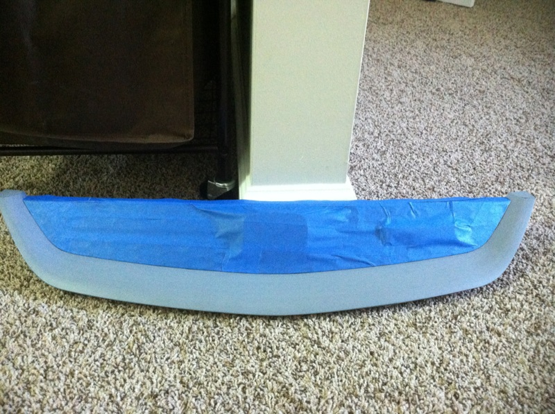

2.) Tape along the edge of where you want to paint. You want to overlap the tape a little onto the part that your painting.

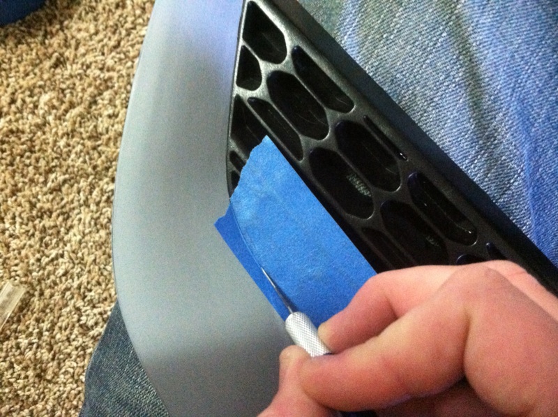

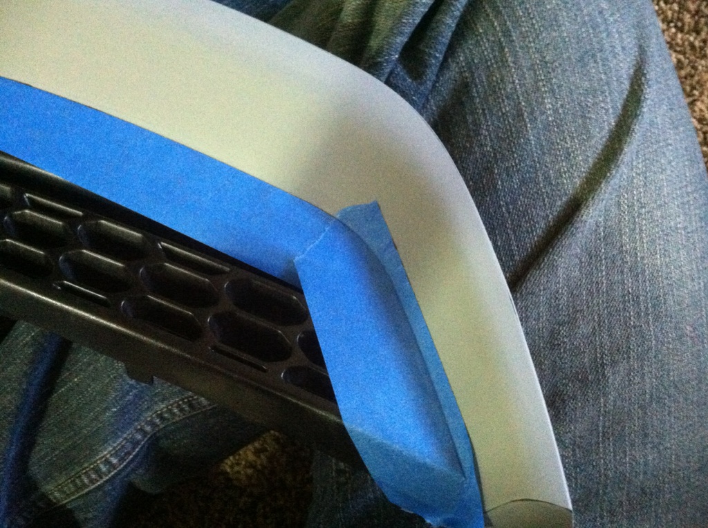

3.) Now take you knife and cut along the edge peeling away the tape that is covering the part you want to paint. Press firmly on the edges of the tape when you are done cutting. You don't want to allow any paint slipping in under the edge.

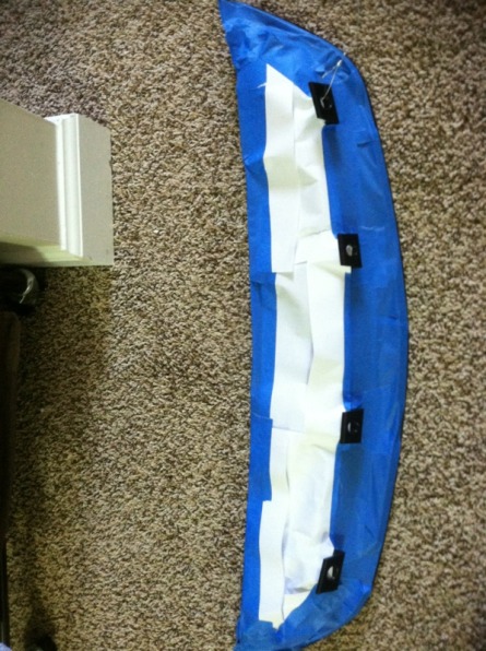

You can use small pieces of tape around any turns, just be sure to overlap your tape so that you don't get any seepage through.

4.) Use newspaper or computer paper to cover any large areas. You can use your painters tape but the paper will cover a larger area better.

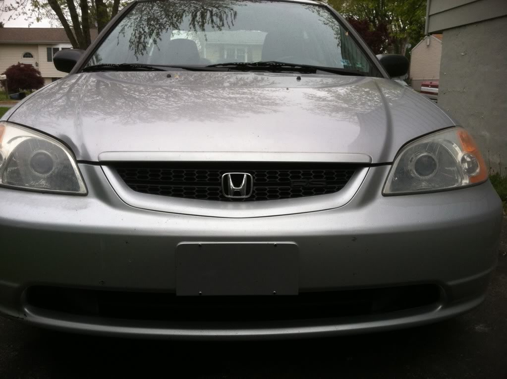

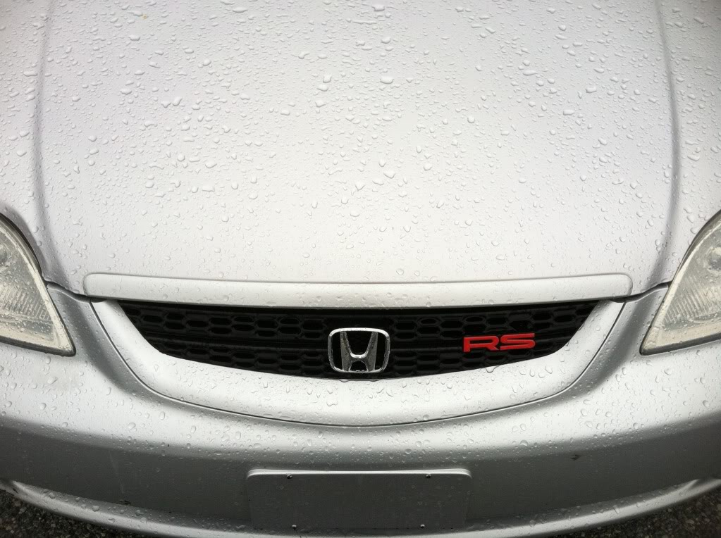

Here is the finished product:
I ended up blacking out the RS with Plati-Dip:

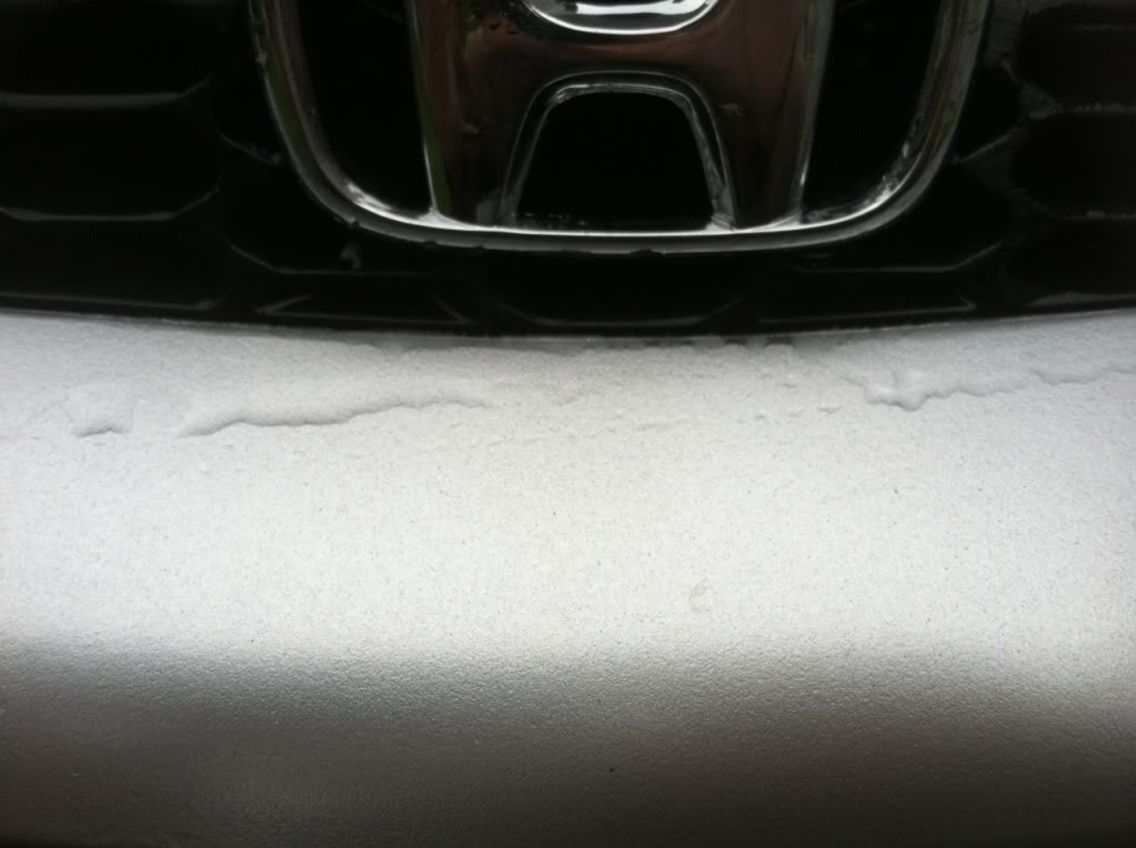

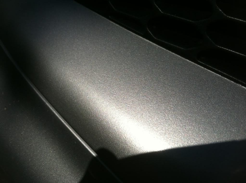

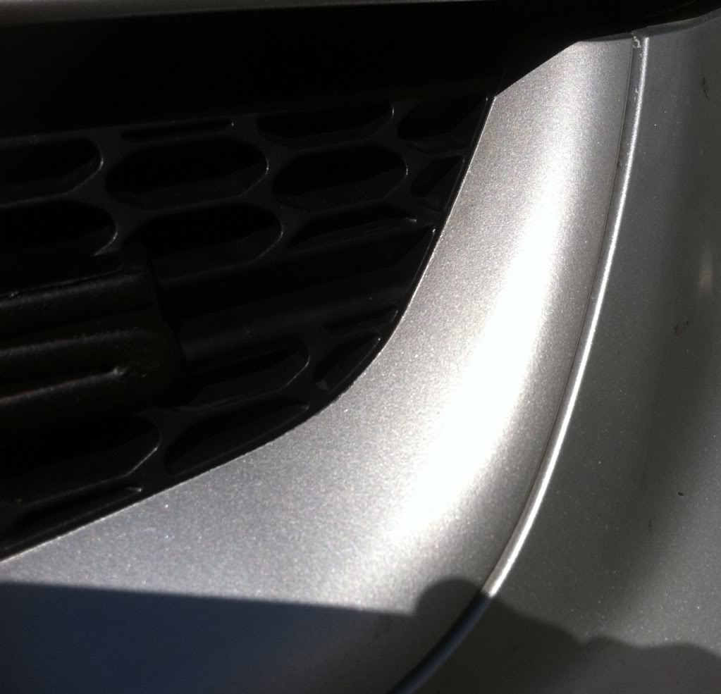

Here are some close up shots. Finally got a day with no rain! I think it matches pretty well. It helps when your paint is 12 years old and it is not garage kept.
