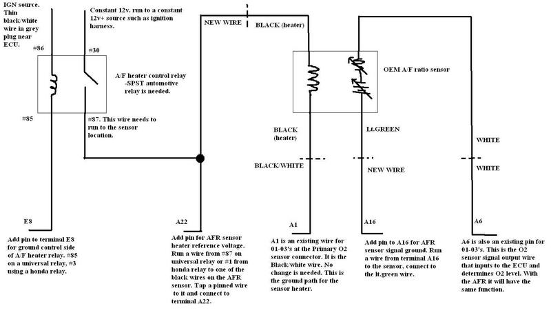

Procedure: 3 pins are being added to your ECU, a relay is being added to the circuit and a sensor is being replaced, obviously.
The first step is to drop your glove box and get to your ECU. I prepared my wiring on the bench, outside of the car. it's a fairly simple circuit.
You can use a honda relay if you want, but a generic radio shack relay works fine. I labeled the diagram for both. If you're using a SPST relay, you have 4 pins, if you have a SPDT relay you have 5. Either way you only need to use 4 pins, if you get a SPDT relay, just terminate pin #87a.
pin 85: connect this to the thinner of two black with white stripe wires in the wide grey plug near the ECU.
pin 84: connect this to pin E8 in the ECU.
pin 30: goes to a constant 12v source such as the ignition harness
pin 87: goes out to the sensor.
inserting pins is fairly simple. it's easier to show on the grey plug. youll notice it has a wide white insert, using a pick or small screw driver pry it up a little. you cant pull it all the way out.
ignition tapped here for the relay. be sure to solder and tape this connection.
finally, there are two wires you will snip out of the factory o2 connector, and where you will add the two you just ran out to it. you will also need to change the gender of this plug, if you cant get a connector, you can hardwire the o2 sensor. I used some snazzy heat deflecting loom to mine and extended my wires since my primary AFR sensor is no where near the stock location. If anyone is interested I can make a few "kits" that include everything you need for this conversion and have it prewired and labeled so you can simply run and plug in your wires. Anyways, once youve done this your car has officially been converted to 04-05 o2 sensor layout. now you simply follow the directions on hondatas website to enable the secondary o2 sensor, which just requires you to move 2 pins. Moving them is just as easy as putting them in, once the lock is lifted out you can gently tug on the pins to get them out of the connector.
Im going to update this thread when i feel like typing more. do this at your own risk. My first impressions are....damn. i cant believe i drove my car without this for as long as i did. the difference is night and day and having the AFR datalogged with everything else makes tuning a hell of a lot easier. have fun.

From: southern Illinois
Re: DIY: Converting primary o2 sensor from narrow to wide band for KPRO USE ONLY
alright, performed said actions, any idea why i have 02 heater circuit malfunction code? p1166(yes i know it can be disabled, but i dont want to burn out sensor)
Old Jun 21, 2009
skipbarber's Avatar
Posts: 4,248
From: Rockville, Maryland
Rep Power: 332
does the relay click on when you turn the ignition on?
Old Jul 9, 2009
greeen01civic4d's Avatar
Joined: May 2006
Posts: 3,188
u know thats a damn good question, ill have to look into that. for now im tuned so its not as important, but id still like it to work
