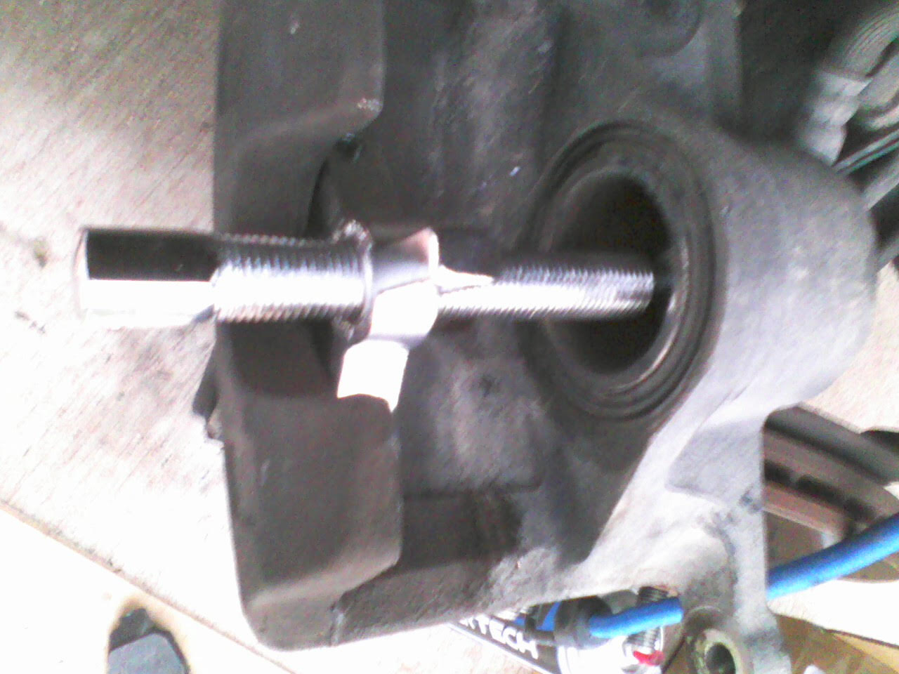

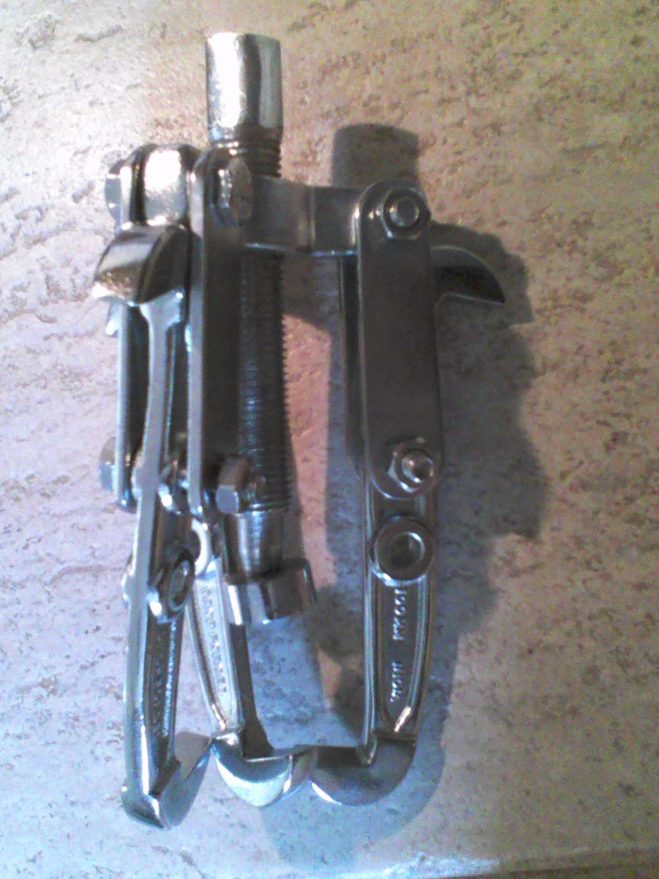

Would be a great addition to
https://www.civicforums.com/forums/1...out-clamp.html
Lol
Feel free to utilize the pictures
Lol
