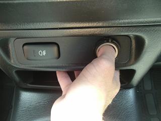

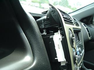

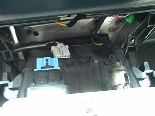

Step 1: Remove the cigarette lighter and fog light switch plate. I just stuck my thumb in and pulled out. Shouldn't be very hard.
Now unclip the wiring harnesses.

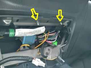

Step 2: Remove the two (2) screws holding the AC controls and Radio in the dash. This is where the 5/16 socket will help you to break the screw loose. After the first time these screws will come off with a screw driver very easily.

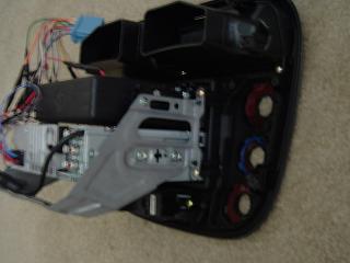

Step 3: Removing the AC controls and Radio
You can use a flat head screw driver to gently break the clips loose on your dash. Be careful not to gouge your dash.

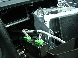

Now unhook all the wiring harnesses from the back of the AC controls and Radio.

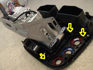

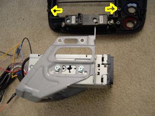

Next take your whole AC unit and radio inside. Why work in the heat or cold when you can be comfortable inside, right?

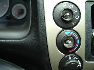

Step 1: Take the ***** off the AC. They just pull right off.
Step 2: Unscrew the back of the AC controls. There are three screws.

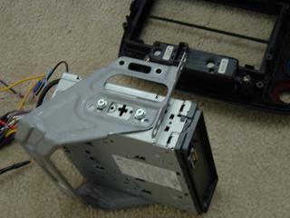

Step 3: Mount your aftermarket radio in the bottom slot. I took the radio bracket off too. It has four (4) screws around the outside edges.
Most Pioneer, Alpine, and Eclipse mount right up to the side ISO holes. Screw it in tight.

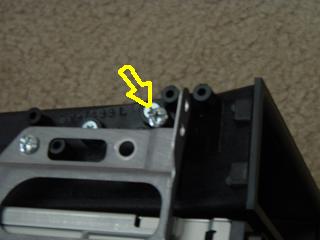

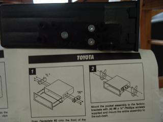

Next we are going to mount the pocket. This is the Metra 88-00-9000 universal pocket. It comes with directions for Toyota, Nissan, Volvo, etc. but no Honda directions. I used the Toyota mounting brackets.
Step 1: Screw the bracket into the side of the pocket with the supplied screws.
Step 2: Now mount the pocket to the stock metal bracket (with supplied screws) where the radio used to be.
The pocket will only have 1 screw slot that fits. So, I took and screwed in the extra screws to give the pocket some stability. Now the pocket rests on the screw I just screwed in the side.
Step 3: Mount the stock bracket back up the the AC control and Radio panel from the dash. Wiggle it a little to get it back to the stock holes if the fitment is tight.

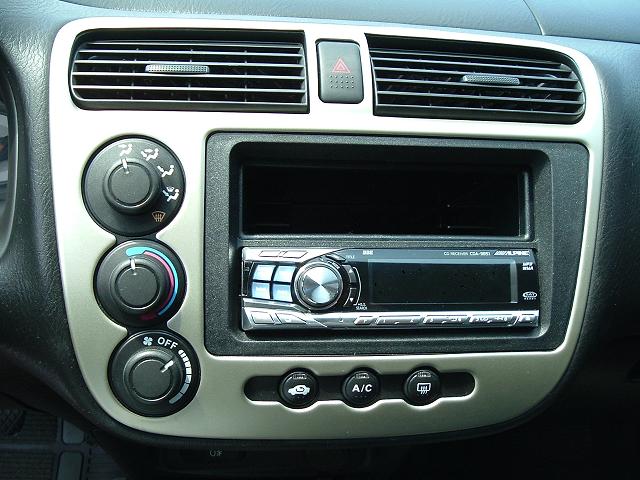

And the final product:
