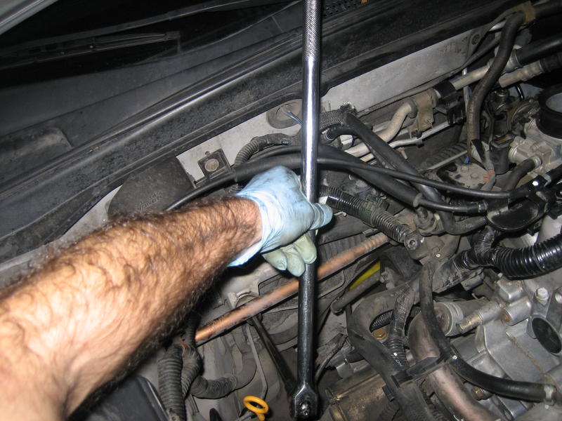

7836 - Remove the screw holding steering rack in place. Shave arms if hair is getting in the way.
