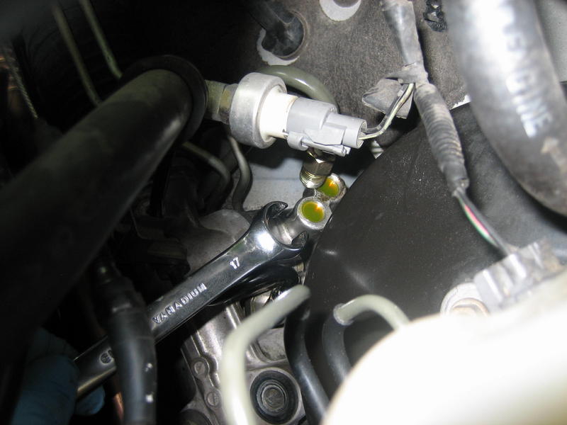

1) Buy a Service Manual from helminc.com. If you do serious work on your car without one, you deserve every problem you encounter.
2) Follow instructions
Tips:
1) Called Majestic Honda and they said that it came with inner tie-rods but not tie-rod ends. It did not come with inner tie rods. Lesson learned is don't open the box Saturday at 5 pm like I did. Had to go Napa
2) Don't gamble with rounding out the nuts on the flare fittings for the in and out to rack - get a tubing wrench (14mm and 17mm). Like $15 for a set at Harbor Freight
3) Thanks to the forum, I did not have to pull the steering wheel/airbag - just used a seatbelt as mentioned and it turned out fine
4) Count your threads on the tie-rod ends and also measure the distance from the rack to the tie-rod end with a measuring tape so you don't have to get an alignment
5) Torque the tie-rod ends by holding with a crescent on the bolt and crows foot fitting on the tie-rod end. Remember to put the crows foot at a 90 angle so it won't change the torque
6) Make sure you have new fluid on hand. Fill reservoir, start car, and start pouring in fluid because it won't have enough. Follow procedure to bleed air (turn lock to lock a few times). The pump sounds bad at first but it will calm down and sound fine.
7) Buy the tie-rod tool at Harbor Freight for $20. It's worth it IMO.

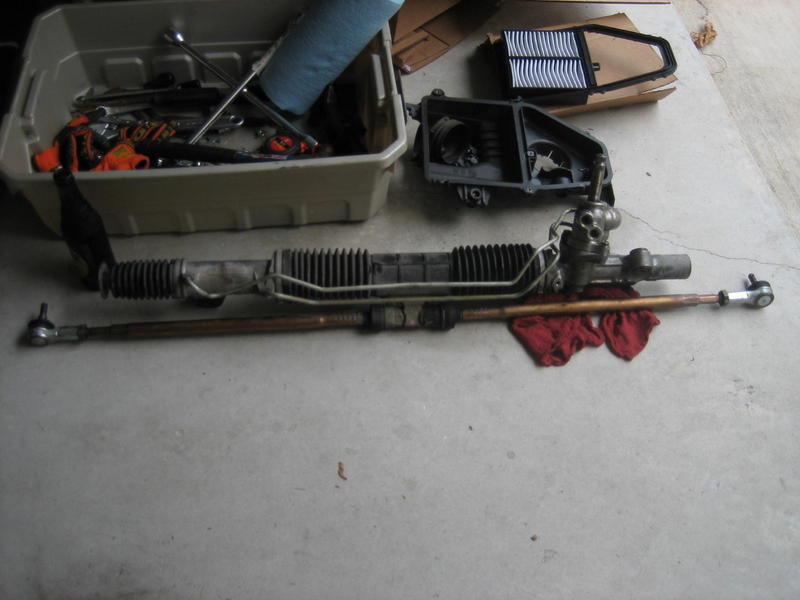

7826 - New steering rack from Majestic Honda

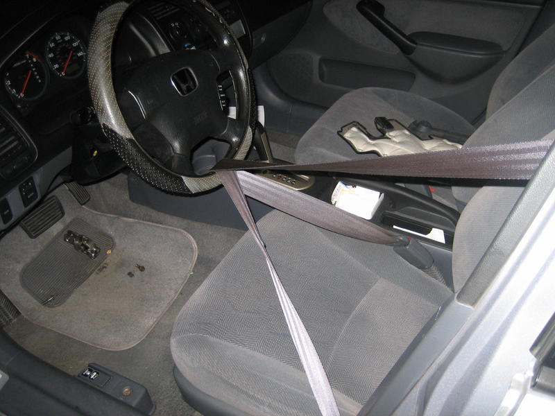

7827 - Use seatbelt to hold steering wheel straight and prevent from turning/damage

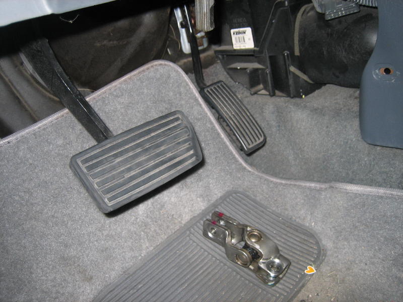

7828 - Remove steering linkage from pinion

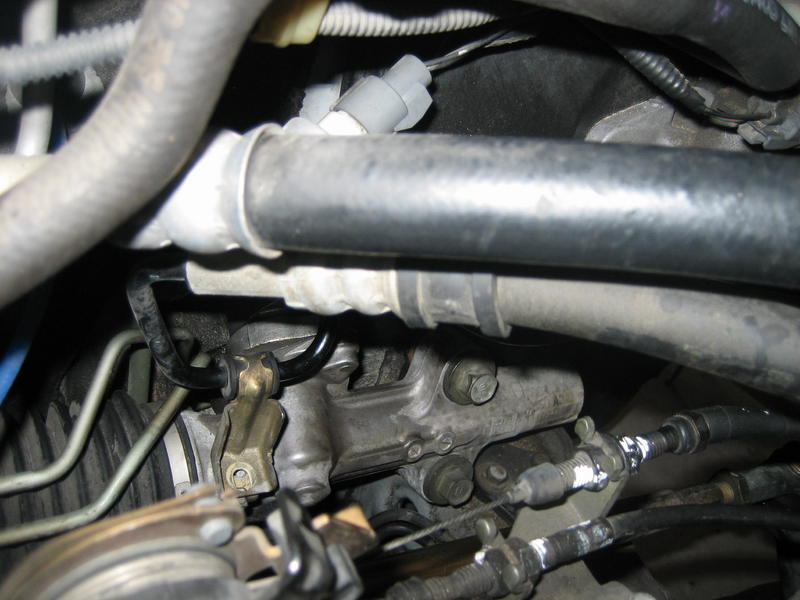

7829 - Another shot of steering linkage with leak area from pinion

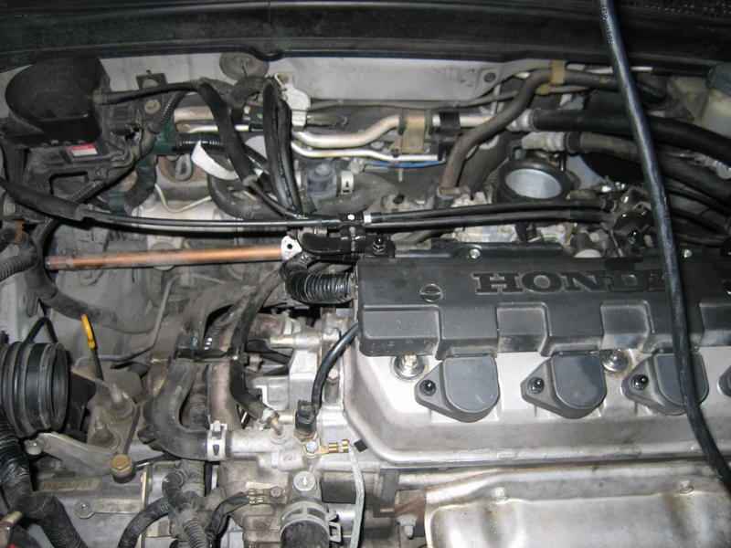

7830 - Remove resonator and air filter
7831 - Remove heater valve bracket

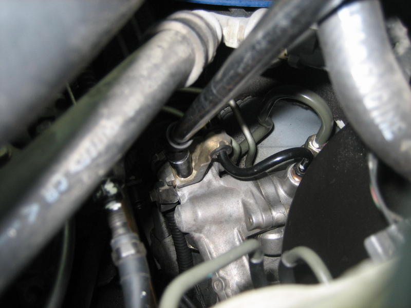

7832 - Remove bracket holding return line

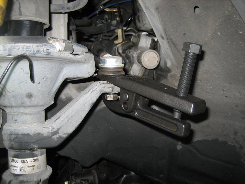

7833 - Disconnect tie-rods with special tool

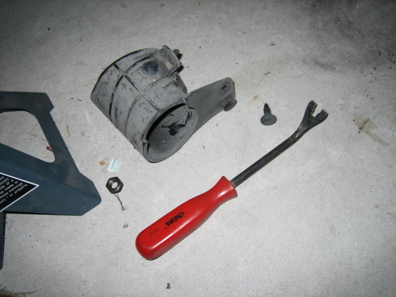

7834 - Remove plastic cover on passenger side with special tool (like $10 at autozone, saves a lot of clips)
7835 - Place the cover was located

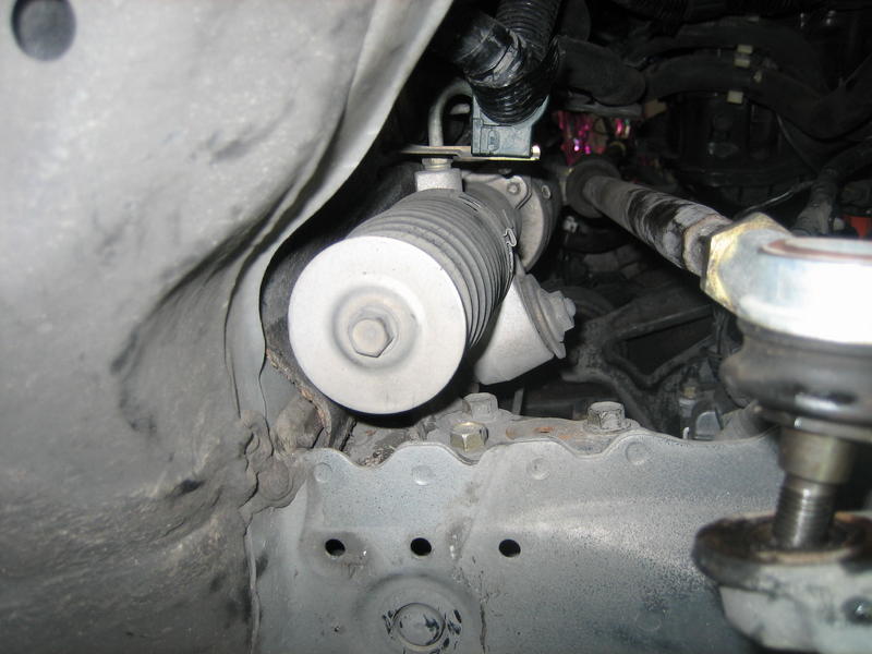

7836 - Remove the screw holding steering rack in place. Shave arms if hair is getting in the way.

7838 - Remove supply and return fittings. Note the tubing wrench.

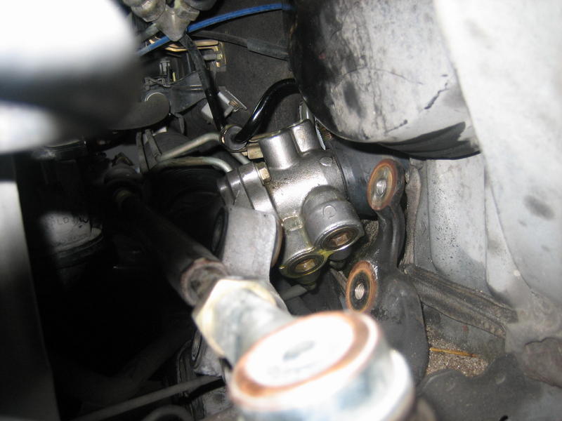

7839 - Remove last two bolts holding rack by the supply/return
7840 - Old rack. Fish it out by turning it up so the pinion is straight up and down and then pull it out the passenger side. Might need a hand because the tie-rods can get tangled and move separately from the rest of the unit.
7841 - New rack with aftermarket inner tie-rods. Here's an interesting find - one of the first inner tie-rods I bought from NAPA had the inner tie-rod WELDED onto the tie-rod assembly (if you can believe it!!!). I didn't catch it until I got home and had to return it and told NAPA, wth??! The guy just shook his head. They replaced it with something that looked a lot closer to the Honda ones. Pisses me off that I had to use aftermarket though.
