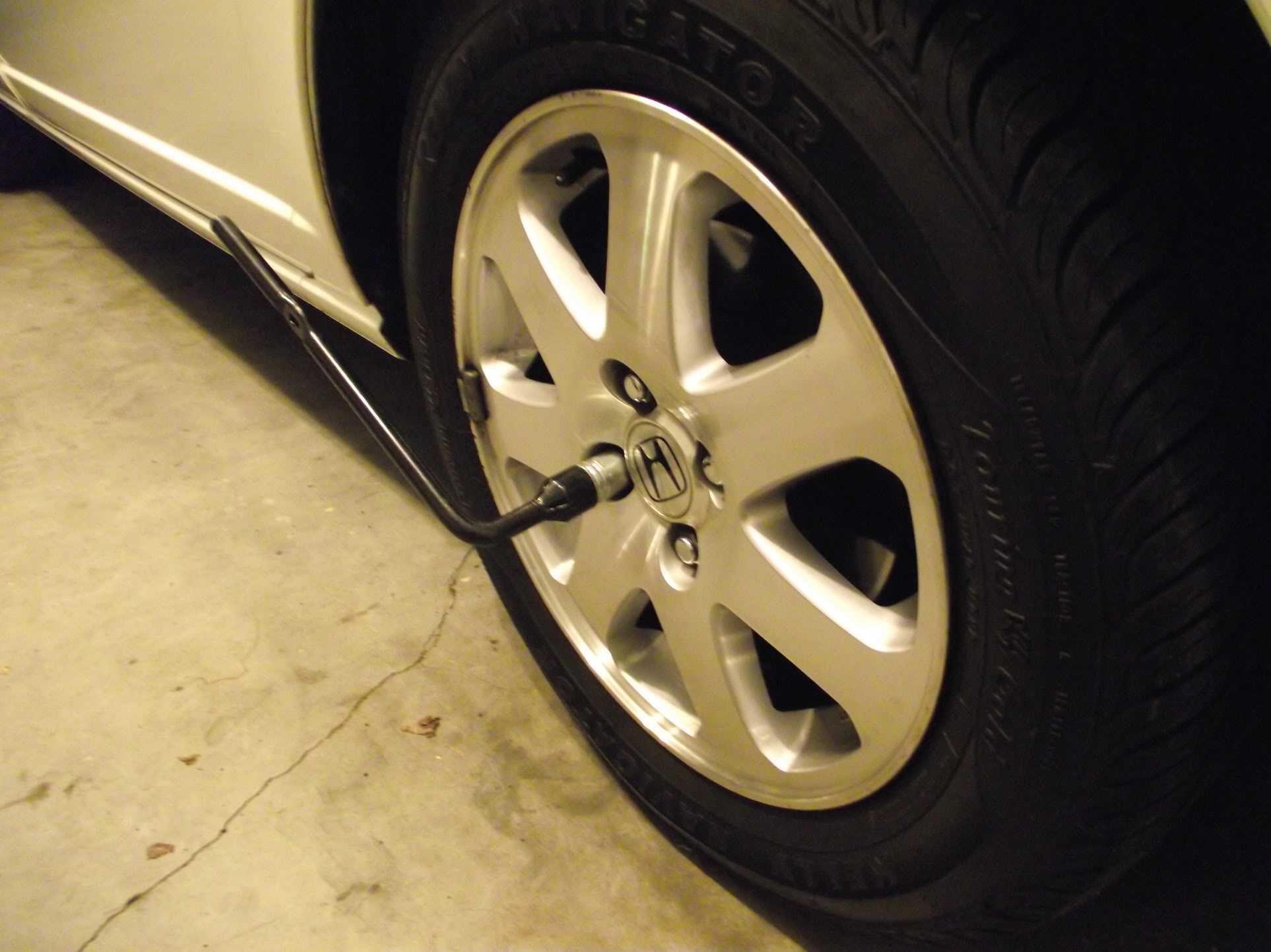

Step 1:
Loosen Lug nuts first! While car is on floor, if you have tuner lug nuts, or a OEM Security nut, use the adapter to loosen your lug nuts

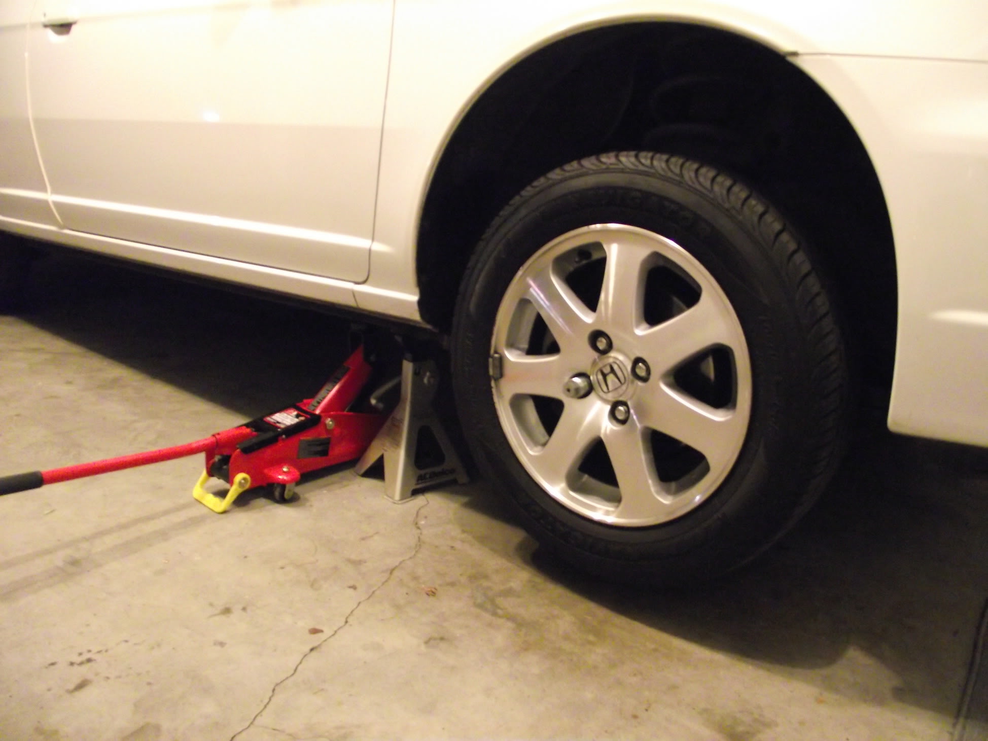

Step 2:
Jack up car and set it on stands

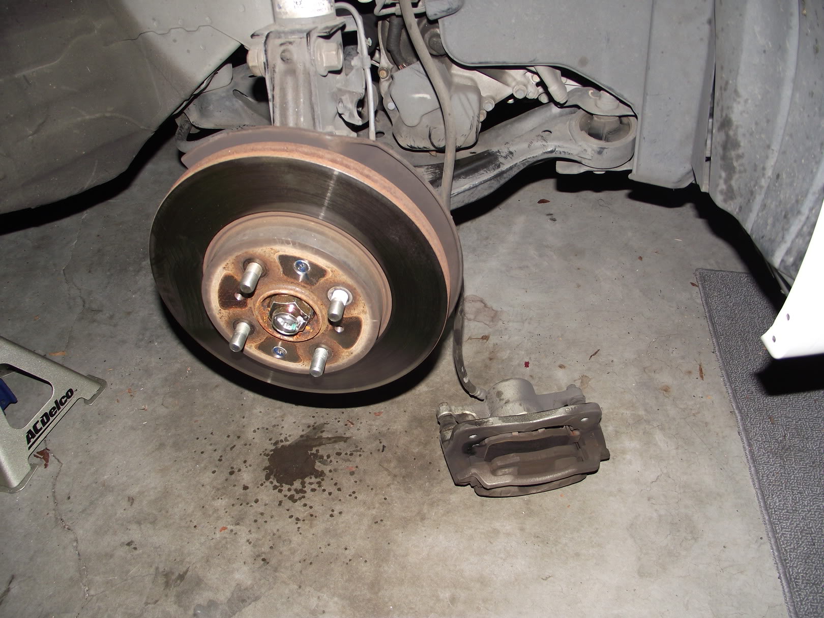

Step 3:
Remove lug nuts and then proceed to remove wheel

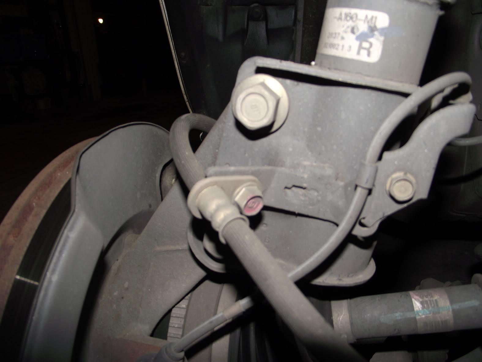

Step 4:
Grab your handy dandy 12mm socket and remove this bolt that holds the brake line to the strut

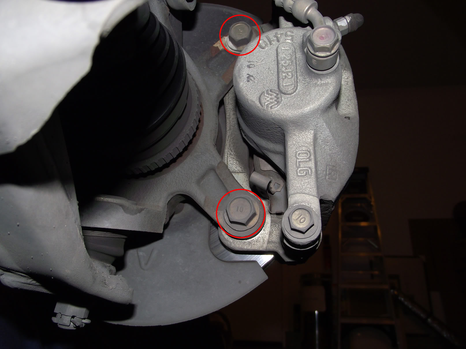

Step 5:
Grab your other handy dandy 17mm socket and remove these two bolts that hold the caliper on the rotor
Step 6:
Realize that top and bottom bolts are seized, and kick the top one a couple times, remove the bolt.
Continue to bang and hammer and pull on lower bolt for 2 hours, and making a life discovery that asian men are small enough to fit all the way inside the front fender of a civic.

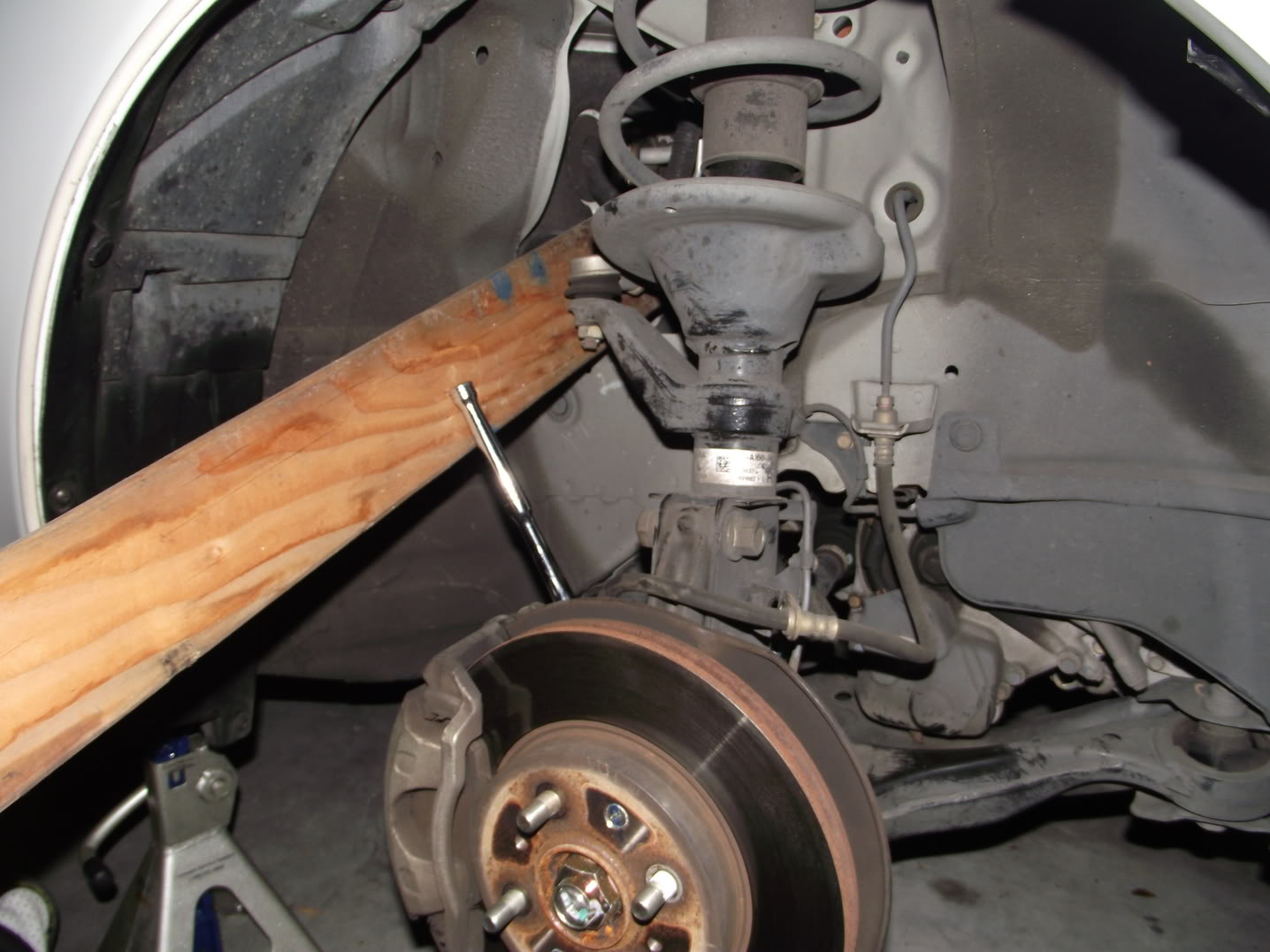

Step 7:
Continue WD40 soaking the seized lower bolt, then have a moment of ingenuity. Grab a 2x4 and pry that bad boy loose.
Sigh of relieve when hearing the first crack.

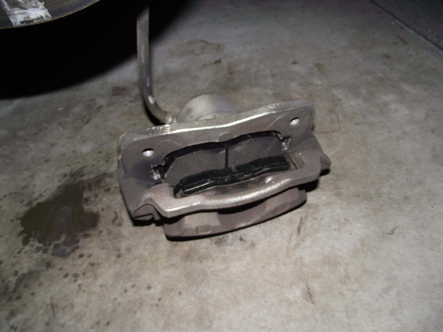

Step 8:

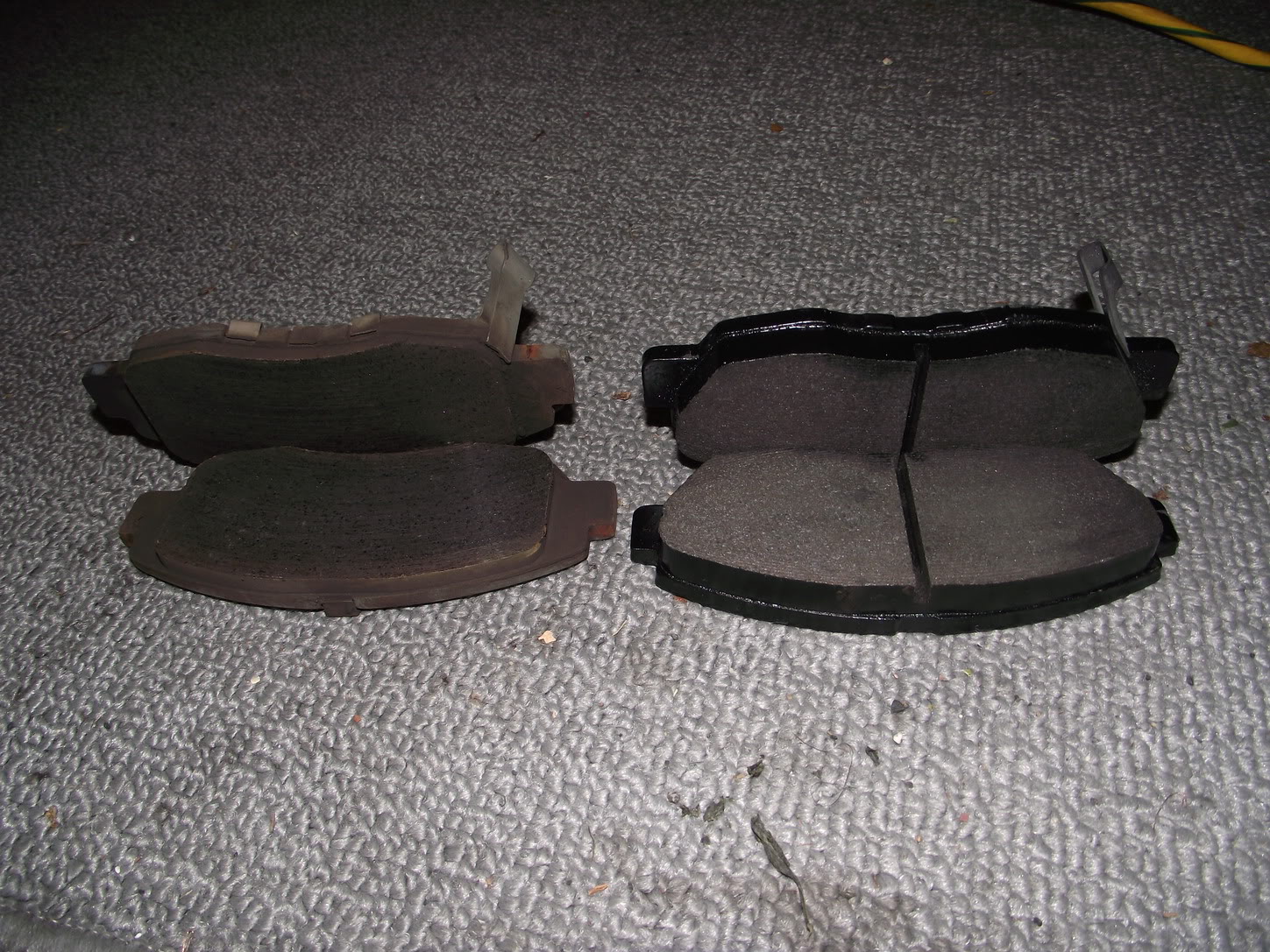

Lay the caliper on the floor and pop out the original brake pads

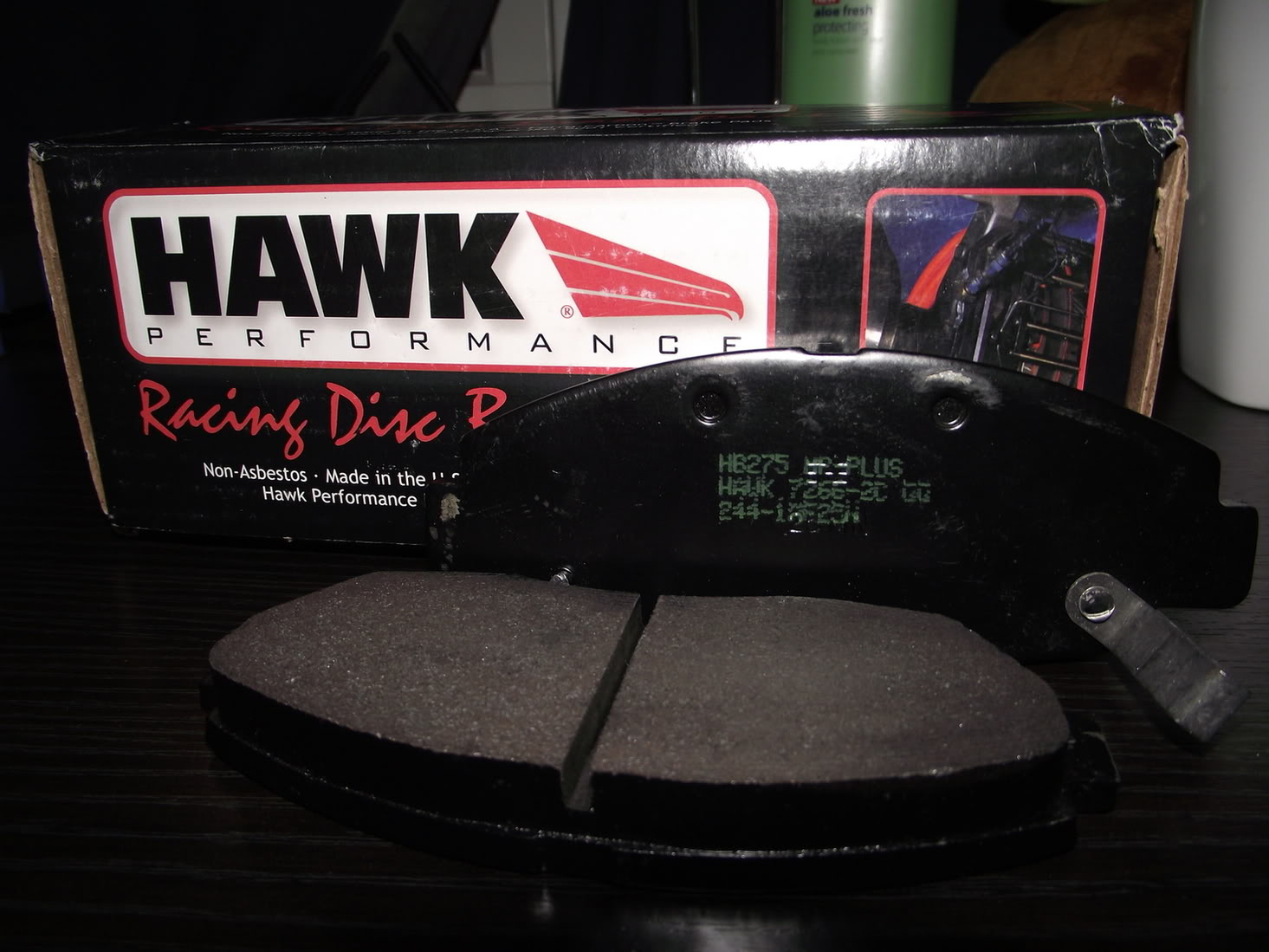

Then compare them to the new brake pads

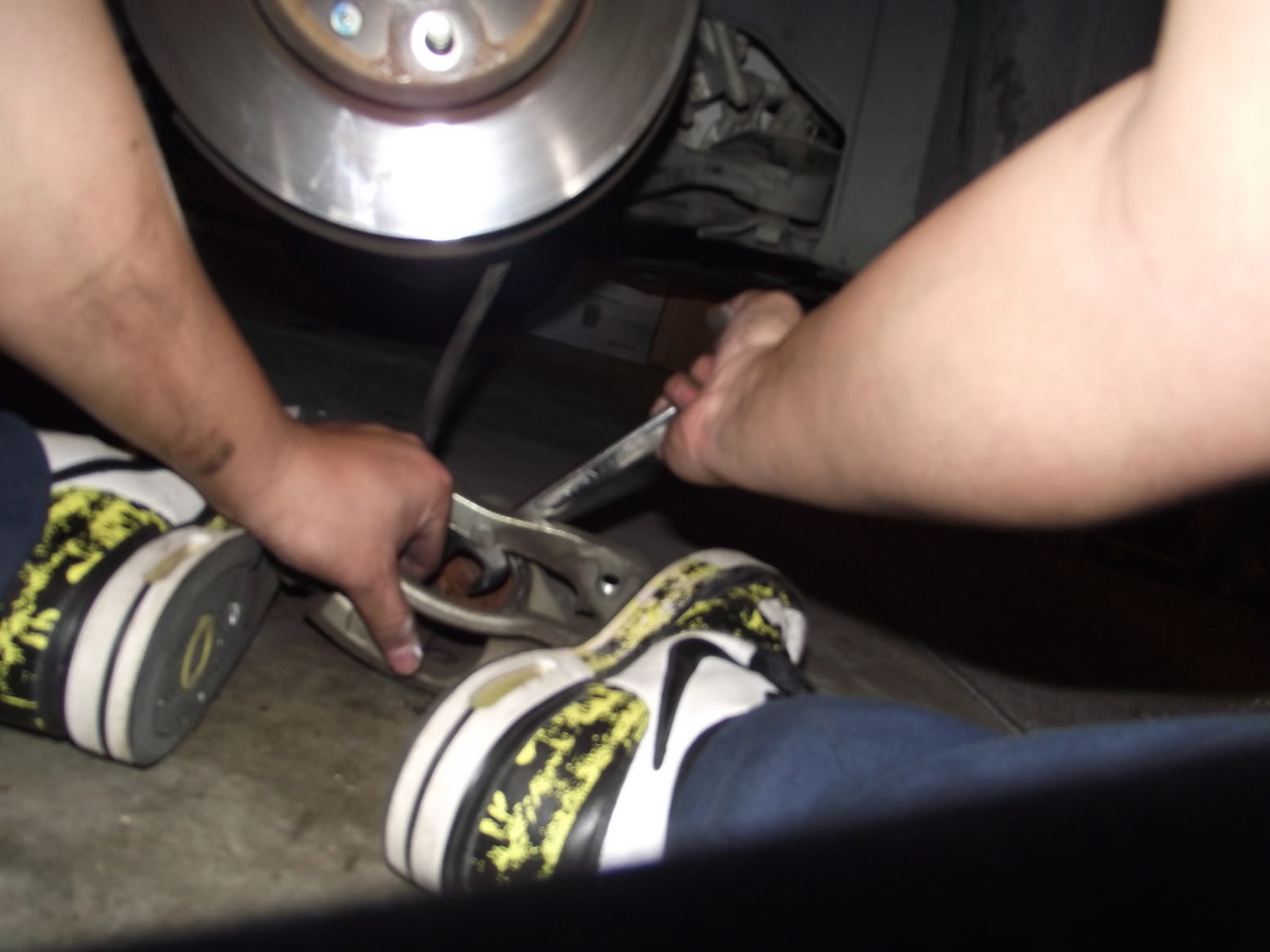

Find an odd enough position for you to pry and push the piston back in without a clamp
(The other side didnt work with this method, but a adjustable pipe wrench squeezing the side and piston worked)
