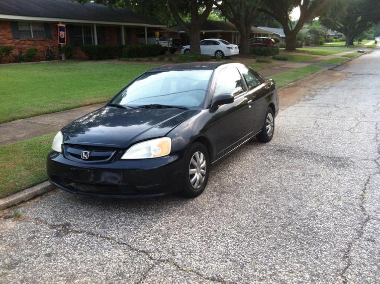

Hey all. I picked u an 2001 Civic coupe DX for a deal. I drove the wheels off my old 86 Accord so I'm hoping this will be as reliable. But I know I need to fix previous owners f'ups. Thankfully only 2 other owners. 1.7 auto. Since I've bought it I always thought it was dark blue and it is actually black.
