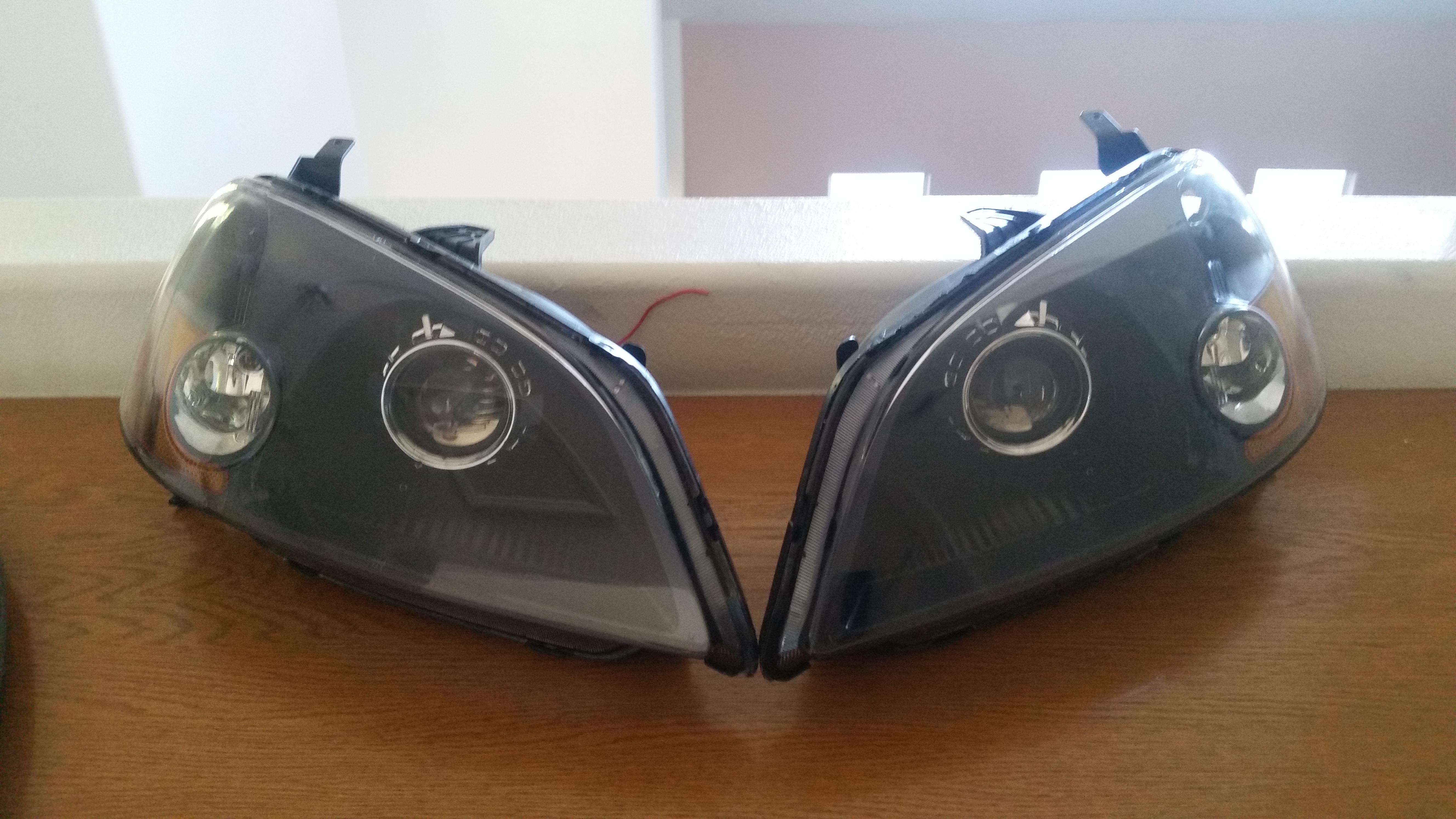

Out with the old....
And in with the new!

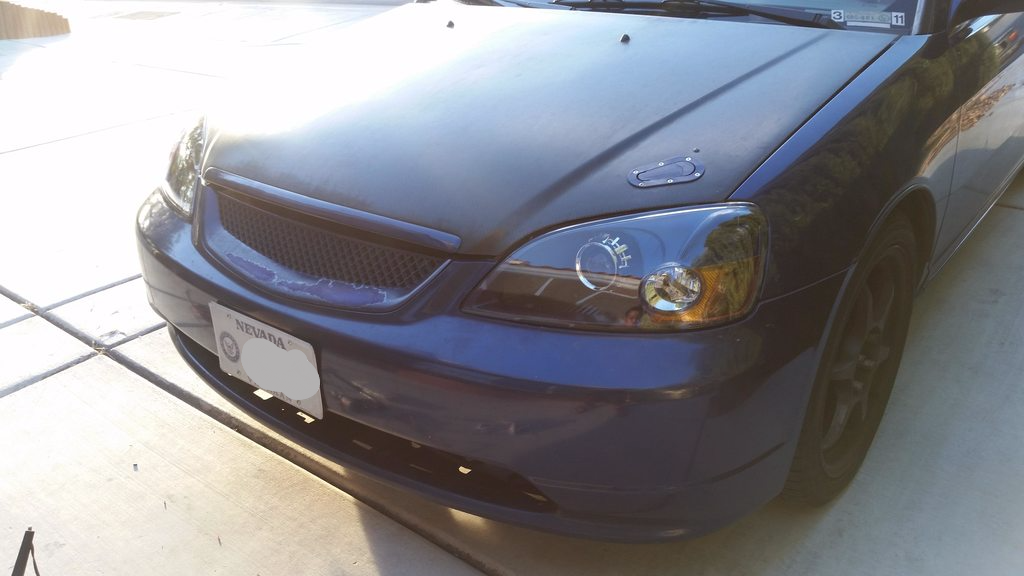

Installed

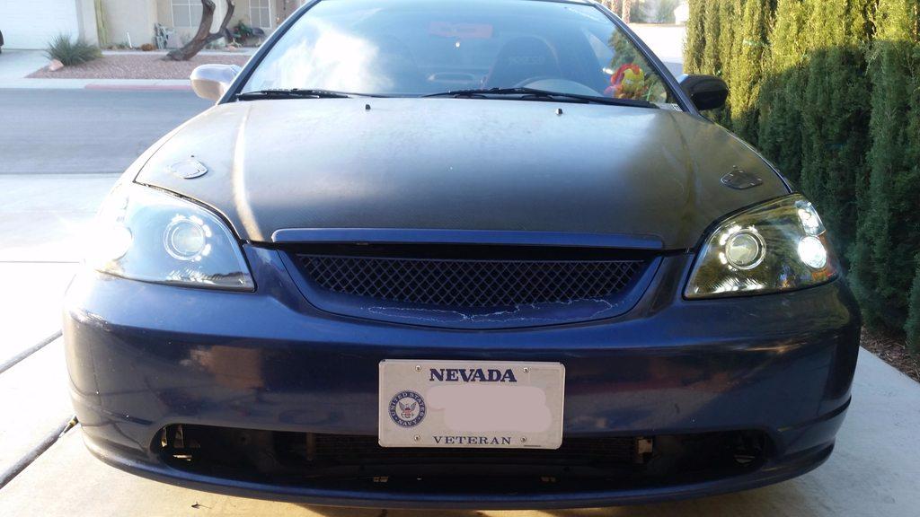

Lit
Closeup of (driver's side) headlight all lit up, sans low beam
Yep. Be jealous.

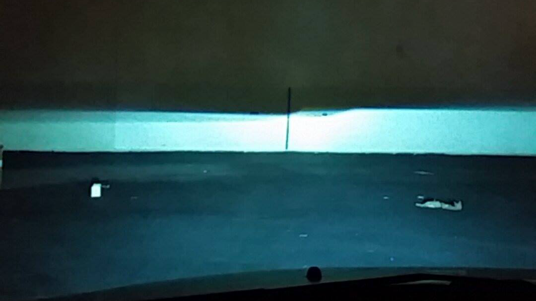

meh, rotational alignment is off somewhere.
Initially thought it was driver's side, but after driving around, I'm pretty sure it's the passenger side that's off. Also, L/R adjustment doesn't seem to wanna work on the passenger side. I really don't wanna bust these things open again. lol

When I did the wife's car a year or so back I ended with a small amount of rotation and slight cross eye. It didn't bother her but drove me nuts whenever I drove the car. Hers has the MD2S 3.0 which suffer from a downward bowing cutoff and combined with a thick spot in the front lenses it had a very ugly wall shot.
A few weeks ago I fixed the rotation and most of the crosseye, but if they are not adjusted correctly side to side it will drive you nuts watching the steps move towards each other and then apart on dips and bumps.

Third, I don't know why, but the rotational alignment couldn't be fixed 100%. Enough for me to notice, but not give a huge **** about. Oh well.
