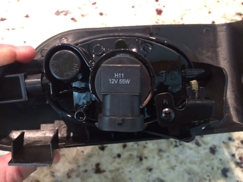

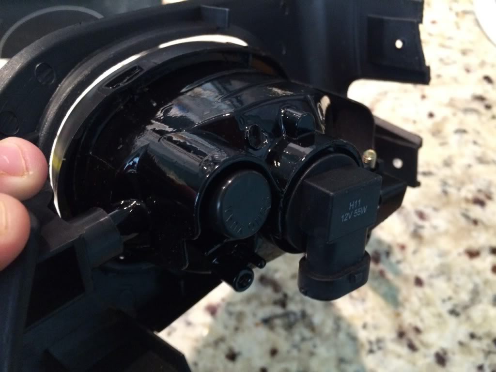

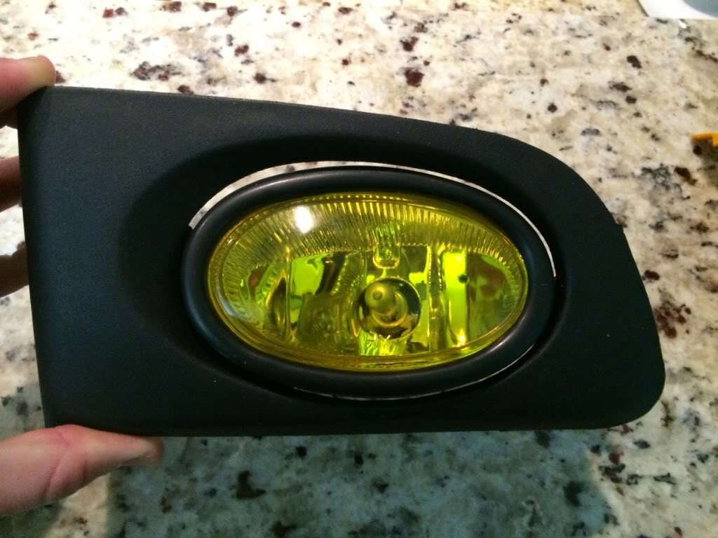

I have Spec D fog lights and the quality is not bad for the price. I have yet to Instal them so the light pattern may not be that great. I did replace the relay that came with it with a higher quality one. OE are the best quality and then Password JDM brand seem nice.

The style depends on the year. The pics I posted are for 01-03 The full lens ones are 04-05.

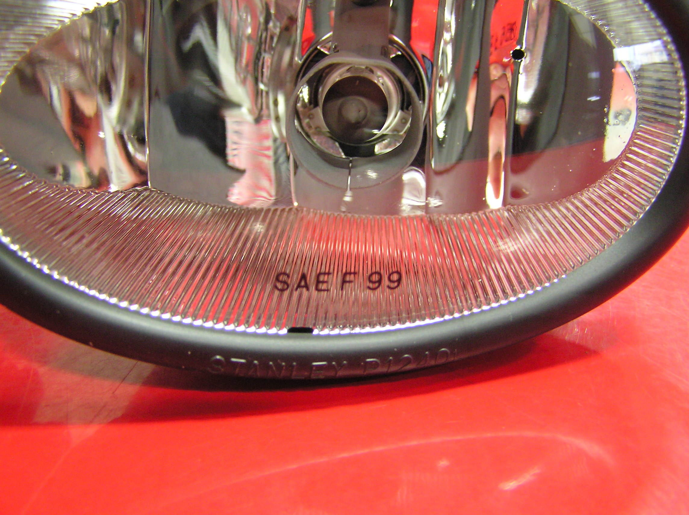

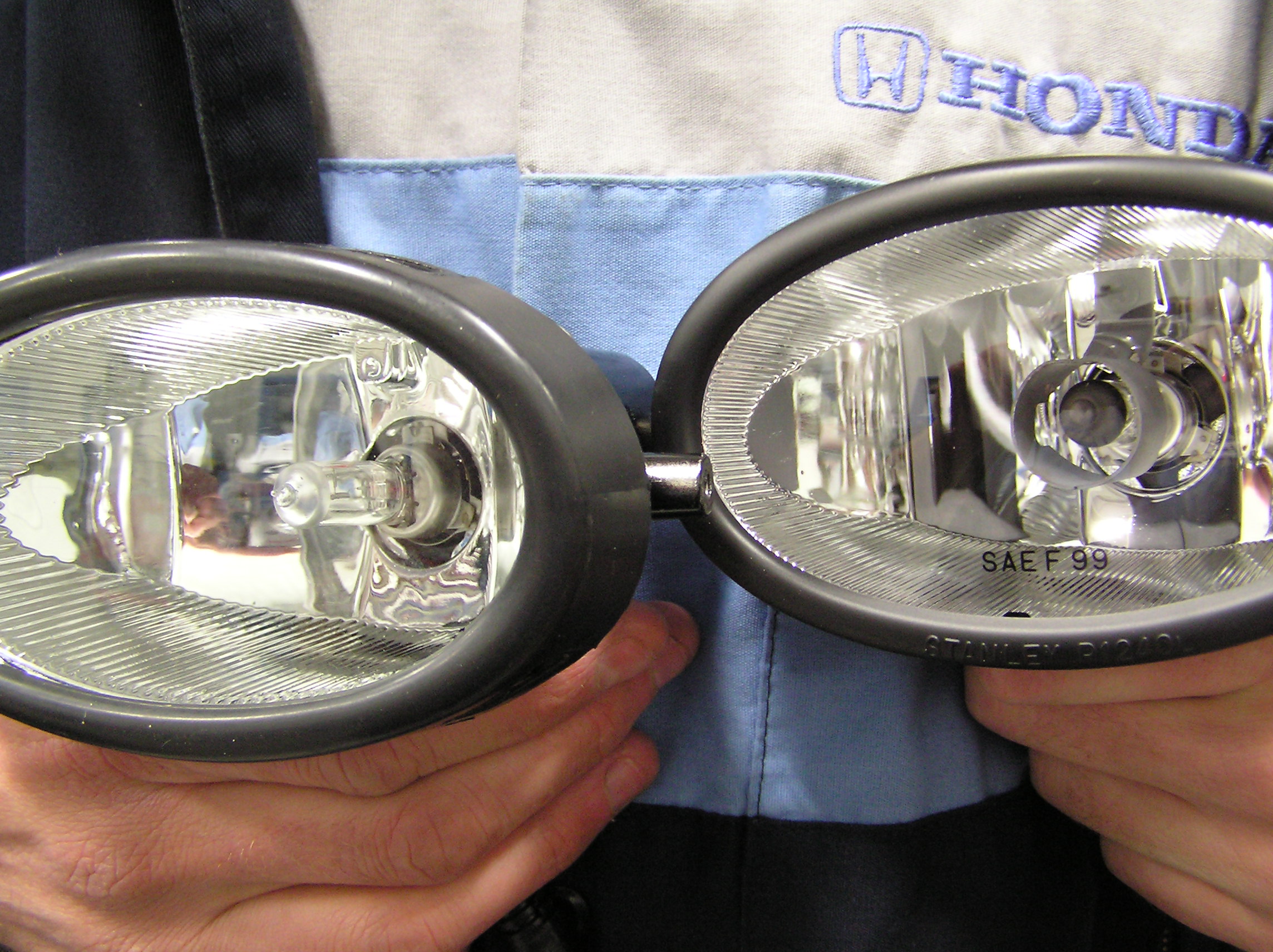

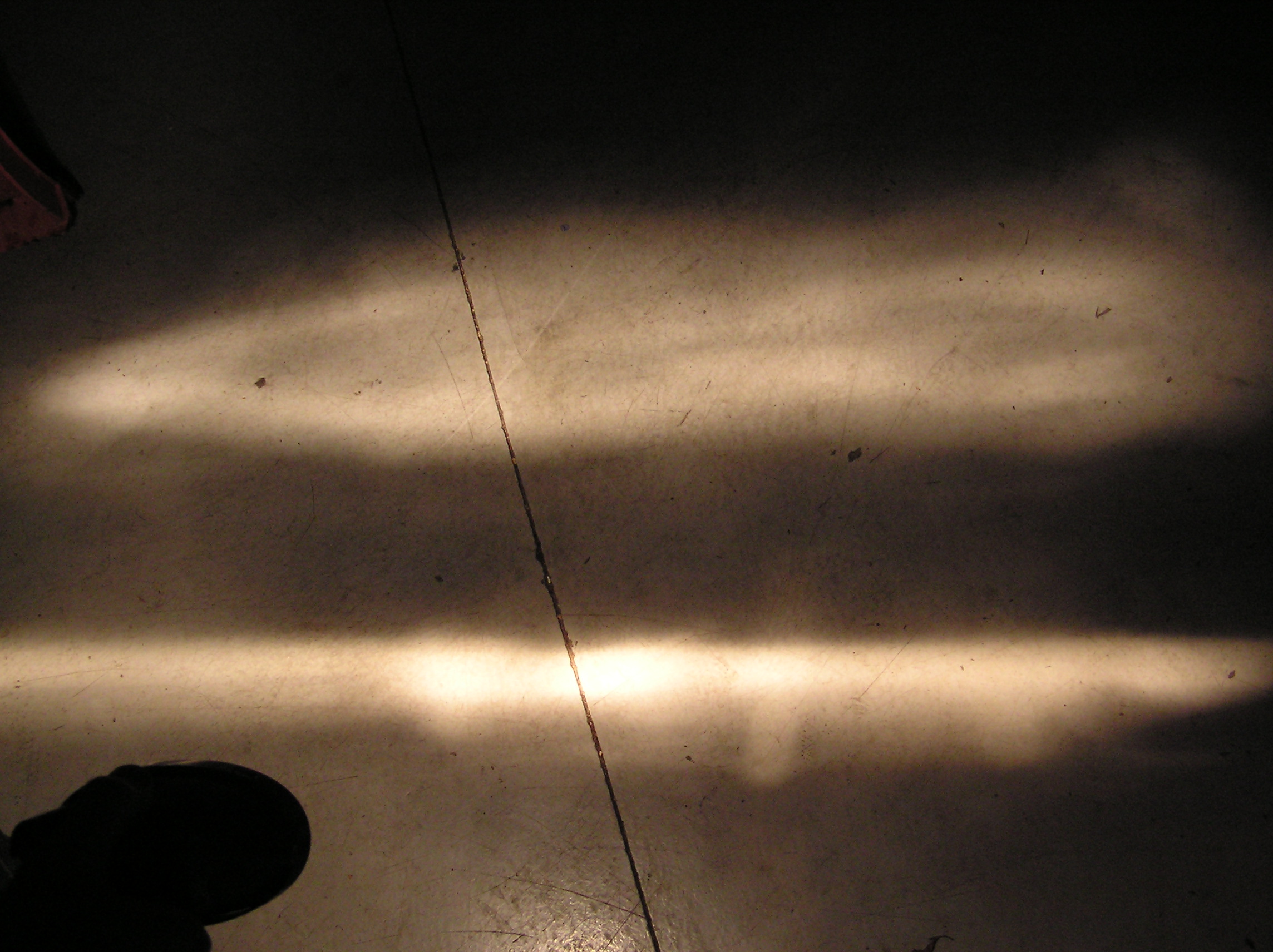

GolNat, the fogs in your pictures look nearly the same as what one of my cow-orkers got from the internet.
I took a few pics of it side-by-side with a NOS HONDA accessory fog (Stanley)
Notice the reflector around the tip of the bulb in the NOS
The actual SAE number on the NOS lens
The name STANLEY and part number on the black trim ring
I didn't get pics of the backside of the units, but the Honda one has the name HONDA and STANLEY molded into it.
Also not pictured, the gaps in the sealant between the lens and body of the aftermarket unit. Looked like it would eventually fill with water.

And the most important part that counts, the beam:
These were just held about chest high and pointed at the shop floor.
Aftermarket units beam on top. Looks more like a floodlight to me. If there was really any fog, it would suck as a foglight.
Honda unit has a nice almost perfectly flat beam with the hot spot in the center.
Guess which one will actually do the job of a foglight.....

Great pics ezone!! The beam pattern of the none oe is garbage. Yes, the cheap eBay kits require some silicone around the lense to prevent leaking.
Any relay is better then the one that comes with it but I used a Japanese made one. I doubt there are more then a few aftermarket fog light manufactures so I am sure most of the ones on eBay/Amazon are similiar.

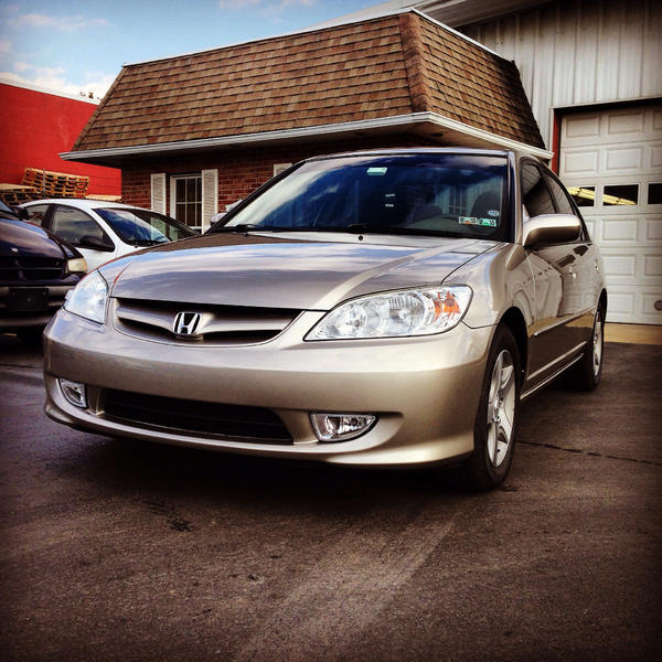

I picked up a set from eBay a few months back and just got around to installing them on my 05. While the set I got wanted me to run in on the driver side, I went on the passenger side with them. I had the front of the car painted recently so it was easy with the nose off the car. I can't find them in my purchased items list on eBay now for some reason. Maybe the seller got pulled off eBay? They were like 40 something shipped. Pretty straight forward install. I just had to use my dremel around the center console where I mounted the switch in the factory location. I used the knock out there. I have fog lights on all my cars but these really light up the road nice. I'm very happy with them.

They fit perfect in the bumper. My bumper is OEM Honda as far as I know. I just had to ream out the hole gently to get the tab on the lights to fit in there. A little at a time I went till the fit was perfect. They are nice and snug. So far so good! Been through some car washes and I've washed the car many times since install. I run them all the time at night. It really lights the ground up to the left and right of the car. Makes a huge improvement when making turns on dark streets!
