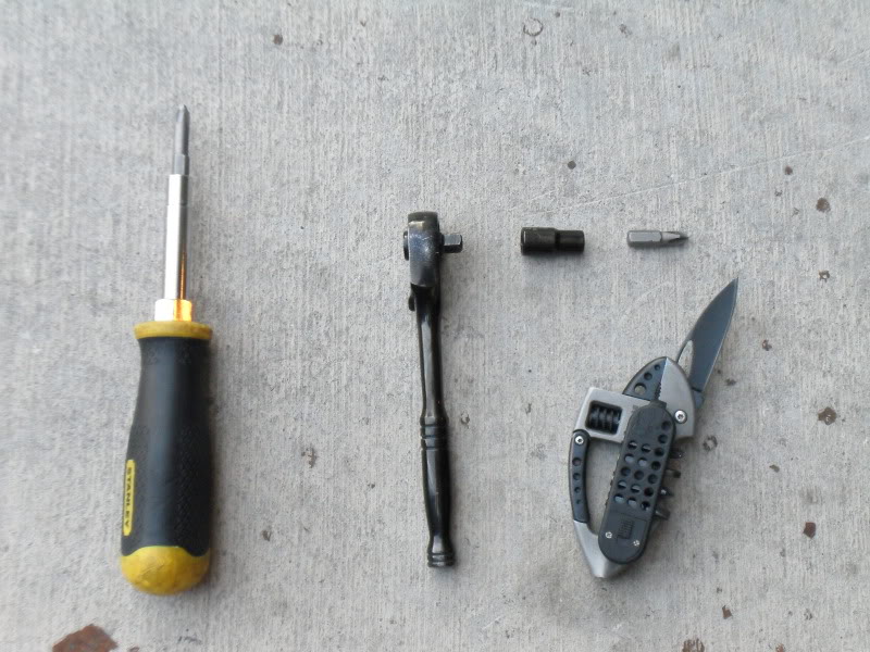

Tools required:
-#2 Philips Screwdriver
-#2 Philips Screwdriver bit
-¼” Drive Ratcheting Socket Wrench with ¼”Socket OR offset screwdiver if you have one
-Knife or thin flathead screwdriver (for prying)
-Soldering Iron (and obviously some solder. I used 60/40 .032” Rosin-core solder) [not pictured]
Tools that help a LOT:
-Tweezers
-Small pair of pliers
-Electrician’s helping hands

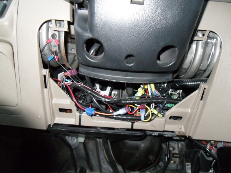

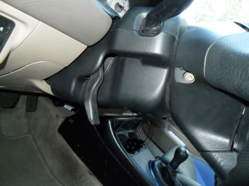

-Locate and remove the 3 screws from bottom of steering column cover. Note that the two that come out of the aft-most holes are tapping screws and the forward most is a machine screw.
-Pull adjustment lever down and finangle the bottom cover off. It helps to take the fuse access panel off. If you grab and pull the bottom cover, it should release the clips from the top cover to take that off.

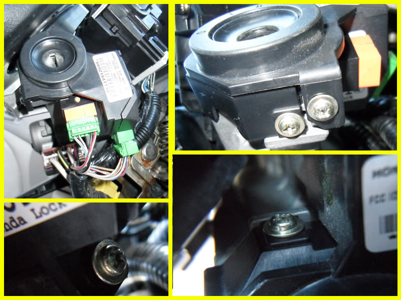

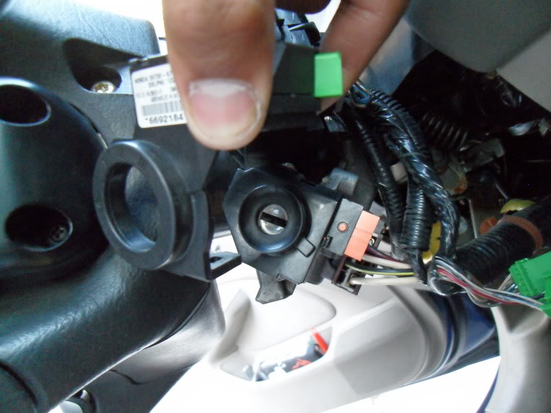

-Meet your ignition switch (top left). There are 4 screws holding this thing down. Working clockwise, there are 2 on the aft/bottom, one on the top, and one on the forward/bottom end. You’ll probably have to nudge some split wire loom out of the way to access it with a screwdriver.
-Remove the 2 plugs green attached to the ignition switch.
-Remove the 2 aft/bottom screws, then the front/bottom screw. The outer-most piece should come off fairly easily. This also allows for easier access to the top screw.
-Use the #2 Philips screwdriver bit and the ¼” drive socket wrench to remove this screw. If you have an offset screwdriver, it’ll work the same.
*Don’t worry about mixing up these screws because they’re all the same*

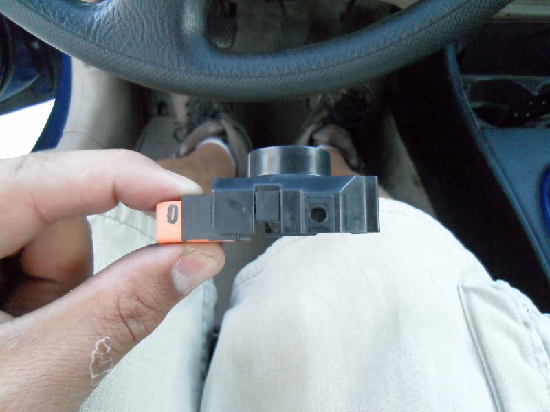

-Once you get the top screw off, the inner cover piece should come off easily. This is the piece that has the LED and diffuser ring.

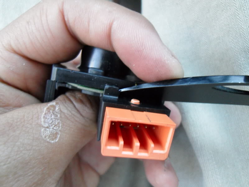

-Use your knife or thin flathead screwdriver to CAREFULLY pry the plastic cover off. There are only 2 clips that you need to release.

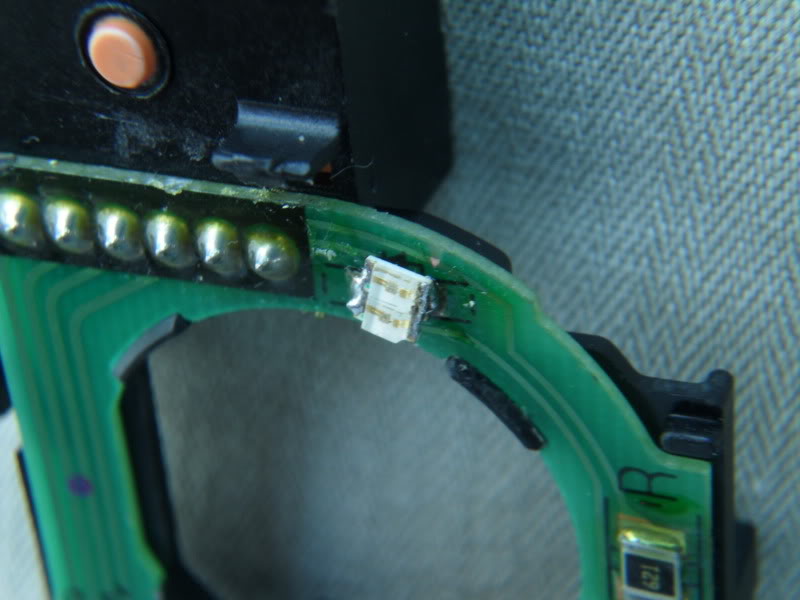

-The diffuser ring is part of the black cover, and the LED is the little white thing close to the orange plug. If you look a little closer, just outboard of it (inboard would be toward the center of the circle that is the green circuit board), you'll see a little symbol that looks like this (without the words or arrows. That’s the electrical symbol for a diode. The cathode of your new LED attaches to the side that’s on the base of the triangle): Name:  118px-LED_symbol_svg.png

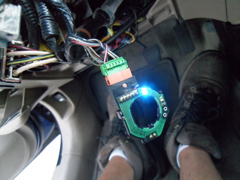

Tricky thing about this part is every component on this circuit board is covered with a clear anti-corrosion coating of sorts, so it makes desoldering the LED either tricky or, in my case, not an option. I took some mini side cutters and cut the old LED off. It exposed the old solder which gave me somewhere to solder the new LED(s) to. **NO PIC FOR YOU**
-I took 2 of my 1206 SMD LEDs, soldered them together (anode to anode, cathode to cathode, i.e. wired in parallel), then soldered them to the board. Not the prettiest soldering job I’ve ever done, but it works just fine. If you look closely, you can kinda see the diode symbol under my LED set.
-Before you put it all together, plug it in (only one of the plugs fits) and test it out. Make sure you dome light switch is set to “door.” If it is and nothing happened when you plugged it in, chances are you left your door open too long and the door timer timed out. Push and release the door switch located in the door jamb to make your car think the door was closed and opened again. If still nothing happens, take a 12V power supply (with a 470Ω resistor on the positive end) and test your LED. If it doesn’t work one way, try the other way. If your LED works, you installed it backwards. If your LED still doesn’t work, you burned out the LED while soldering. Repeat the LED switch process to try again.

SUCCESS!!!
-If it works, congrats. Put everything back together. Everything only goes in one way, so have at it. If you can’t figure it out, go back to pre-school where you tried to shove the square block in the triangle hole, and figure out wtf happened. Lol
Only clips together one way

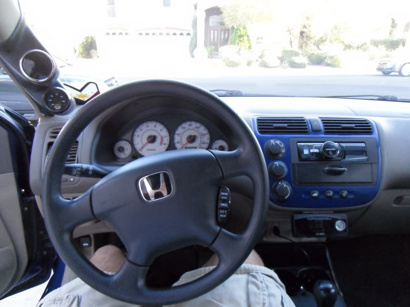

-After you put everything back together, Readjust your seat and/or steering wheel, sit back, and admire how everything (should) looks the same as before you started, except you don’t have a weak *** amber LED lighting up your key hole. (And for you that wanted to see what painting the radio bezel looks like, take a gander to the right. There’s my blue painted bezel.)
