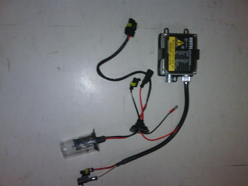

Attatch photo is the contents of my h.i.d kit...no harness that goes to the battery etc.Shouldn't there be more to this kit?I've tried hooking them up to see if they work and they did,but on my test switching on hi beam turns them off.They are 3 wires on my h4 connector red and yellow,red and blue,red and white.Going from the connections on the h.i.d kit,do i still need to use a relay?if so do i use one for both or 1 for each side?Comments/help needed and welcome.

you'd have to buy a relay harness seperate. most HID kit's don't come with them. something like this would work
http://cgi.ebay.com/ebaymotors/ws/eB...m=380059046836
this one might be better with seperate relays and an H4 connector.
http://cgi.ebay.com/ebaymotors/Harne...spagenameZWDVW
that's right. as gearbox said before, you only use the red/yel wire for the positive and you ground the ballast seperate. if you use the low beam ground off the headlight connector, it drops out when you turn the high beams on. if you buy a relay harness and hook it up exactly as gearbox's diagram shows, it will work.
oh, and you can cut off that rubber boot with the 4 wires going through it. it's useless and makes connections more difficult. just don't cut any wires.
